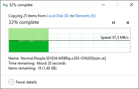

  3. # Anakin Win User
    Slow speed transfer USB 3.0 on Windows 10
    I have a Lenovo IdeaPad 3 15ALC6 laptop but right now I'm facing a issue with Windows 10.
    When I try to transfer files to my external drive (which is a WD Elements 2TB) using the USB 3.0 port, i only get about 87MB/s to 104MB/s at maximum speed transfer. It turns out I have Ubuntu 22.04 dual booted on the same laptop so my first thought was to test the drive on this OS.
    I used the same USB port and tried to transfer the same file to the same external drive and for my surprise speed transfer was about 320 ~ 372MB/s on Ubuntu. So it's not a problem with the external drive nor the USB Port itself, i guess.
    I already did some research, but none of the things people told others to do fixed my problem.
    What I already did:
    • Check for USB drivers updates
    • Uninstall then reinstall USB Serial Bus Controllers
    • Check for firmware updates for my external drive
    • Check for BIOS updates
    • Check if USB 3.0 is enable
    • Change USB removal policy to "Better performance"
    I don't know what else to do, any help? Windows 10 is basically slowing down by more than half all my USB 3.0 speed transfers.
    Windows version: 22H2 OS Build19045.3570
    Slow transfer speeds to USB on Windows 10 0Tc5MmTroVa66CTrNAOJRzaHIIzgmFD3KUjNcdyC3QaO2q%2f%2bzJg3whBngpfOp1U9oAySNpowim2edZmh0LdupkEYQ%3d.png
    # Anakin, Nov 20, 2023

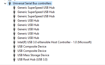

  4. saberman Win User
    Windows 10 slow USB 3.0 transfer speeds
    This thread is locked:
    https://answers.microsoft.com/en-us/windows/forum/windows_10-hardware/windows-10-slow-usb-30-transfer-speeds/a5e1eebb-74bb-4777-8902-5131f3e8ec3e
    @Rajeshwari_Patil said:
    Method 2:
    Uninstall and reinstall the Universal Serial Bus controllers driver and check, if it works. Refer to the following steps to uninstall the Universal Serial Bus controllers driver from the Device Manager.
    a. Click on Windows key + X and then, select Device Manager.
    b. Locate and expand “Universal Serial Bus controllers” in the Device Manager Window.
    c. Right-click on the “Universal Serial Bus controllers” and click on “uninstall".
    d. Restart the computer and check, if it works.
    I have:
    Slow transfer speeds to USB on Windows 10 c91111bb-0147-40d0-a2bb-280404b8af36?upload=true.png
    Which of these do I uninstall?
    saberman, Nov 20, 2023
