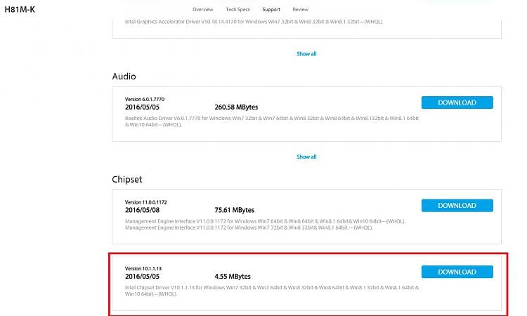

    On the Asus support website, did you click on the "Show All" link under chipset drivers and actually install the second one on the list?

    SMBus Controller
    No, I didn't. I see that it looks to go hand-in-hand with Version 11.0.0.1172. Should have 10.1.1.13 been installed first?
    - - - Updated - - -
    Thank you so much. I forgot to look at that. What is the best way to remove a chipset driver?
