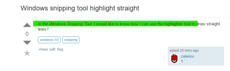

    Windows snipping tool highlight straight
    Windows snipping tool doesn't have any way to let us draw straight lines by pressing Shift. Windows Ink Workspace is another tool that supports snipping and drawing the snipped portion. It has a virtual ruler that helps us to draw straight lines.

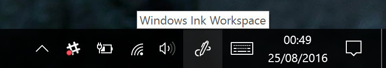

    To enable Windows Ink Workspace
    To launch the workspace, click or tap the pen-shaped Windows Ink Workspace icon that appears in your notification area.

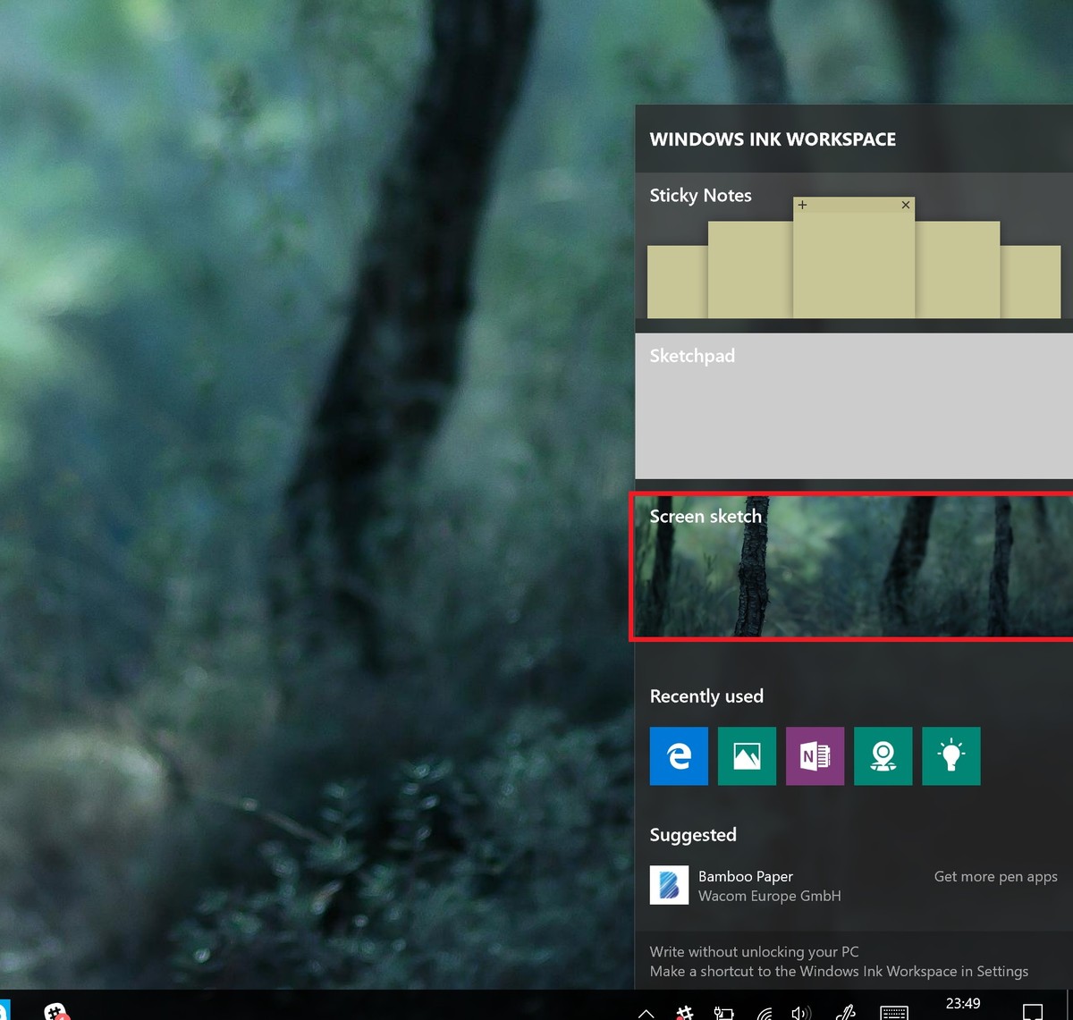

    Snipping Tool Glitch - Highlighted/inked area overlaps when minimized ugDJ8.jpg
    Tap the "Screen sketch" block. It will be the third block in the list. It will automatically take a screenshot of your display and load it for your sketching.
