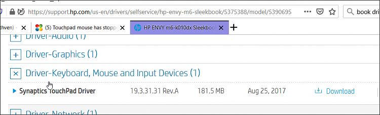

    Hi, have you tried downloading the driver from HP's site?
    https://support.hp.com/us-en/drivers.../model/5390695
    so every now and then my touchpad will stop working when its not working i cant see my... 322808d1615824268t-touchpad-mouse-has-stopped-working-1.png
    As an outside possibility an update you've received may be incompatible with your PC.
