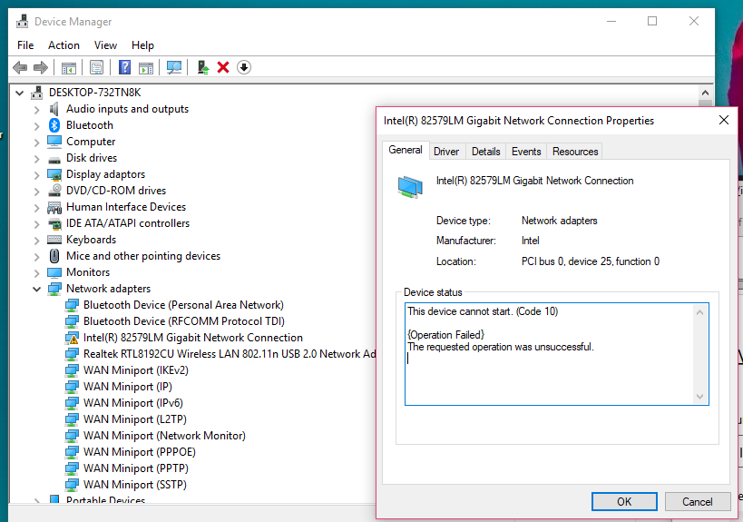

  2. Intel(R) 82579LM Gigabit Network Connection (code 10) driver issue
    I've recently installed Windows 10 fresh onto a p8z68-v gen 3, everything went well except when I tried to connect to my broadband with an ethanet cable nothing was happening, so I checked device manager and it seems Intel(R) 82579LM Gigabit Network Connection
    drivers are getting code 10 any suggestions?
    [SOLVED] IntelR 82579LM Gigabit connecting at only 100 Mb/s in Windows 10 64 bits a87f16a4-a0e3-4792-8b22-28c7e26bfc59?upload=true.png
    CarefulCrysis, Aug 9, 2022
