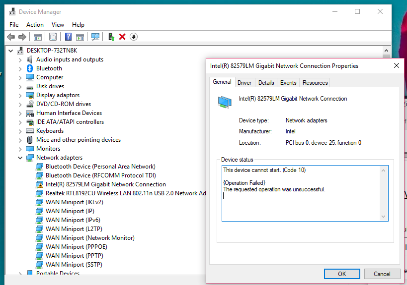

    I've recently installed Windows 10 fresh onto a p8z68-v gen 3, everything went well except when I tried to connect to my broadband with an ethanet cable nothing was happening, so I checked device manager and it seems Intel(R) 82579LM Gigabit Network Connection
    drivers are getting code 10 any suggestions?
