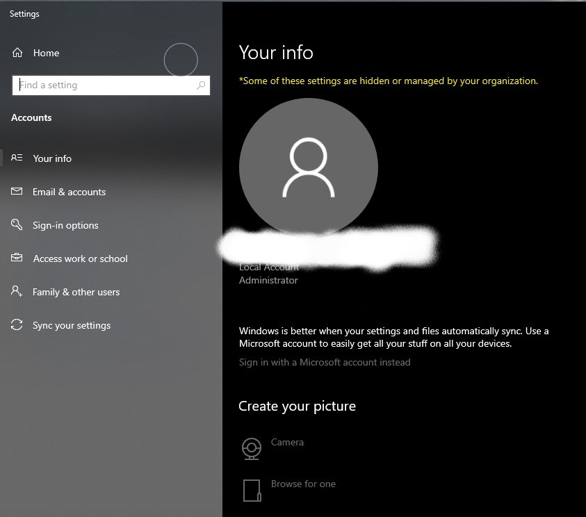

    I hate to beat a dead horse but I have tried many fixes for this message but I do not see one for the User Accounts Screen:
    "some of these settings are hidden or managed by your organization" a1cd8462-cf72-4d92-bcb1-4ff728a2058b?upload=true.jpg
    A little History: Originally I was signed in with a Microsoft account I created when Windows 10 was offered for a free upgrade.That was on another computer. I still have that one and it is using the MS account currently, but I will probably also go local on that one after I figure this out. This is a new PC About a month old and I did the Windows 10 Set up with that account. I have since switched to a local account and disabled new Microsoft accounts and logging in with Microsoft accounts in group policy along with countless other fixes for this error. There are no other setting windows other than Phone and Accounts that display this message. I have checked here and google in general and they all point to other System settings menus, no one that I could find covers Accounts and phone.

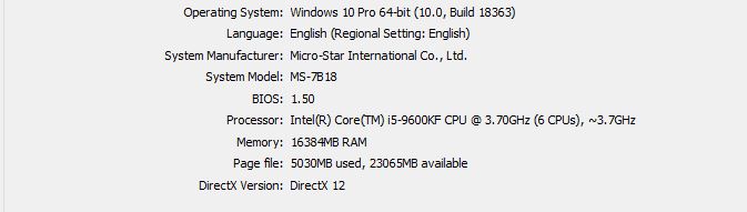

    To be honest I never looked before, I just wanted to go back to a Local account. Here is a screen cap of my system info including windows build.
    "some of these settings are hidden or managed by your organization" 757570d8-a97b-4abe-9737-ff48fffc9322?upload=true.jpg
    Any Suggestions would be greatly appreciated. I know it's a little thing, but those count too right?
    ^_^
    Steve
