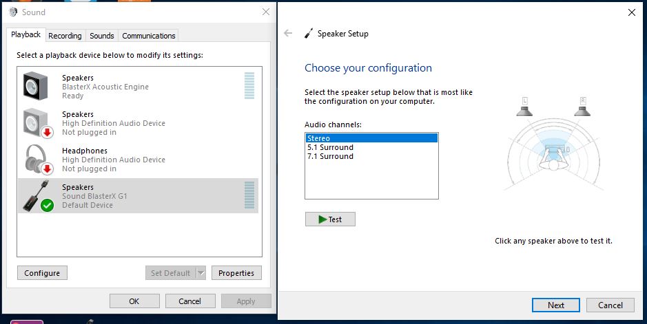

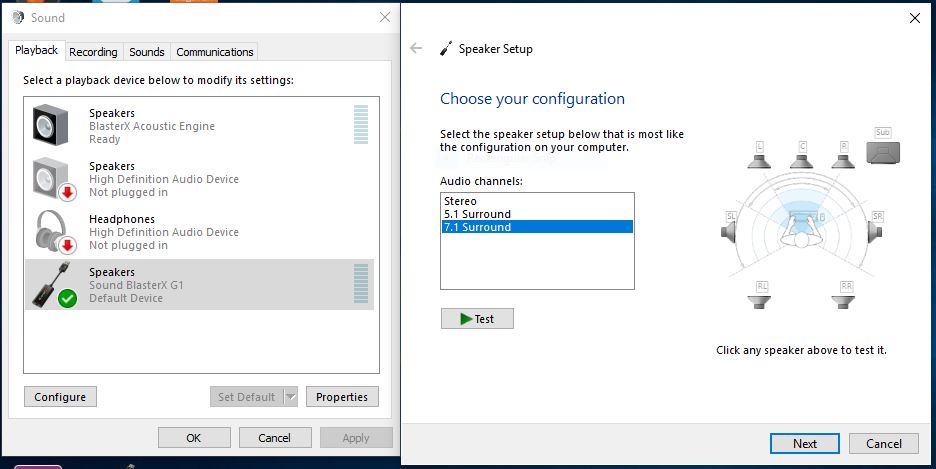

    Speakers configuration keeps reverting to stereo
    Hi there,
    I have encountered a problem with Windows 10 Version 1809.
    When I click on "Configure" on Windows Sound, the speakers configuration will revert to stereo even after I have selected 5.1 speakers or 7.1 speakers.
    The issue also causes the sample rate to revert to a lower setting.
    For example if I have selected 24bit 96kHz on an audio device, clicking on "Configure" will cause the sample rate to revert to 24bit 48kHz.
    When I click on "Configure" and click on "Cancel", the speakers' configuration reverts to stereo.
    Speaker configuration reverts to Stereo upon reboot - with workaround. 2af96bc6-77af-42af-98cd-7b15a7a85891?upload=true.jpg
    Speaker configuration reverts to Stereo upon reboot - with workaround. b70b2825-d562-4fab-9e0f-b84f802864e1?upload=true.jpg
    This is happening on other audio devices as well.
    This is a video I took with the onboard audio device:
    dinopkk, Feb 24, 2020
