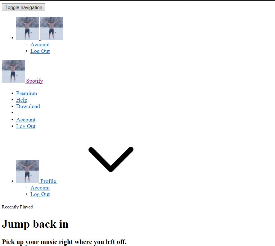

    I noticed just over a week ago that Spotify, although everything else worked properly, would not load images (cover art, artist photos, etc.). Not only did the desktop app not load images, they would also not load on websites that utilize their iFrame imbeds.
    I got this version of Spotify through the Windows Store but when I went to the Spotify download page to attempt a clean re-install I found the page looking like this:
    Spotify: Incorrect images loading for Local Files? 12563406-f9fe-475f-a991-363837e5d830?upload=true.jpg
    ...as it turns out all of the pages in the Spotify domain are similarly stripped. As for the photo, it's my current facebook profile. Spotify is linked to facebook in all sorts of ways but my account there is NOT through facebook. Needless to say I was not
    able to download the program from the website.
