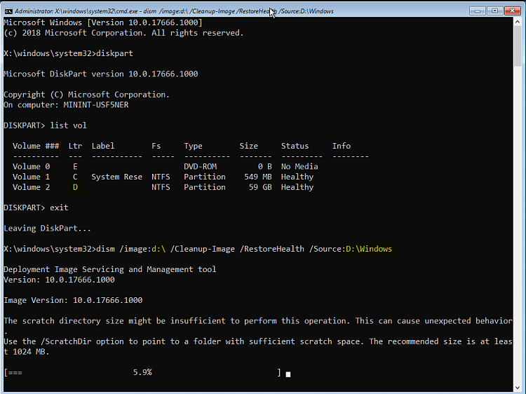

    I assume you are getting Access denied (Error 0xC00005 or similar) when running it?
    Follow these steps:
    Boot to Advanced Startup Options in Windows 10 | Windows 10 Tutorials
    Open command Prompt and run the commands as below.
    Diskpart to get the Windows drive letter and Dism using that drive letter.
    "sppsvc.exe" is literally missing in my PC 189692d1526931698t-sppsvc-wont-start-dism.png
    Assuming that the component store is not corrupted as well. If this does not work change source to a Windows USB/DVD.
    Superfly, May 10, 2025
