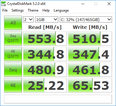

    Yes, I run the test when the disk was completely idle and 0% usage.
    AHCI is enabled. I also run the same test on my 2nd SSD and this one much faster:
    SSD Active Time boosts randomly to 100% 106140d1485972996t-ssd-disk-active-time-100-a-ssd5.png
    I will clone my current system on that 2nd SSD and see if that help. I'm pretty sure that this was the problem.

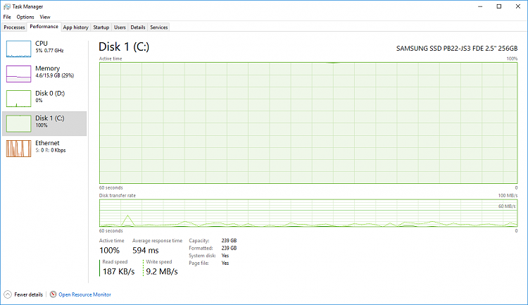

    I have a relatively fresh installation of Windows 10 but it often gets very laggy.
    - Any window takes a while to open
    - Even typing on the keyboard has a delay
    - Programs not responding
    I did the usual checks such as
    - Antivirus / Antispyware
    - Drivers update
    I noticed that my C: SSD disk is often at 100% "Active Time". There are some processes writing/reading from the SSD but that something the SSD should handle without freezing the entire OS.
    SSD Active Time boosts randomly to 100% 106030d1485972958t-ssd-disk-active-time-100-a-ssd.png
    SSD Active Time boosts randomly to 100% 106031d1485972958t-ssd-disk-active-time-100-a-ssd2.png
    Any ideas what's wrong?

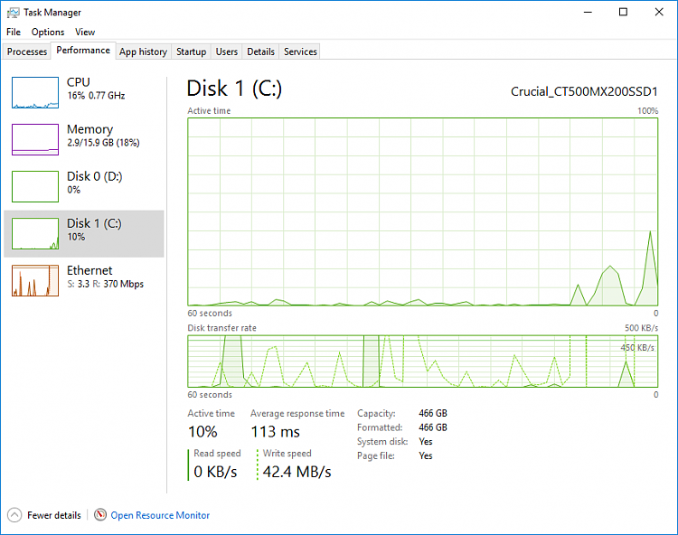

    so the after using the PC for a while with the new SSD, I can confirm that this was the problem.
    The problem on the older SSD was not high usage but the fact that even a "normal" usage was creating a bottleneck on everything.
    Here, I'm downloading at 370Mbps and the disk activity is only at 10% where the older disk would be at 100%
    SSD Active Time boosts randomly to 100% 106279d1485973031t-ssd-disk-active-time-100-a-ssd7.png
    Those are my disk speeds now:
    SSD Active Time boosts randomly to 100% 106278d1485973031t-ssd-disk-active-time-100-a-ssd6.png
    Thanks for your help.
