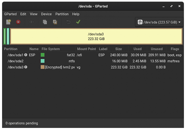

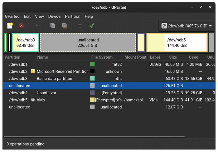

    No.
    I didn't know this was even possible ? How do you do it ? Apart from reflashing a new UEFI firmware ?
    Because if you are talking about the ESP (EFI System Partition), I started with a new clean partition on the new SSD. There is none on the 2nd drive.
    Here is my setup
    SSD failing to boot into windows 10 with error code 0xc00000e 2d1576839966t-windows-fails-boot-0xc00000e-error-hot-boot-capture-d-ecran-de-2019-12-20-09-44-33.png
    SSD failing to boot into windows 10 with error code 0xc00000e 3d1576839980t-windows-fails-boot-0xc00000e-error-hot-boot-capture-d-ecran-de-2019-12-20-12-05-16.png
