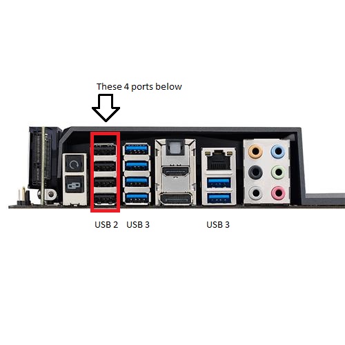

    Update KB4015438 broke all my USB 2 ports on my motherboard. USB 3 are fine.
    Hi all,
    I have windows 10 set up to defer updates and I noticed that there was a update that needed a restart. After the restart my mouse wasn't working I then realised that all the 4 black USB 2 ports on the back of my motherboard were not working any more. The
    6 blue USB 3 ports are fine thankfully.

    I checked my Motherboard BIOS and all the ports are enabled as normal.

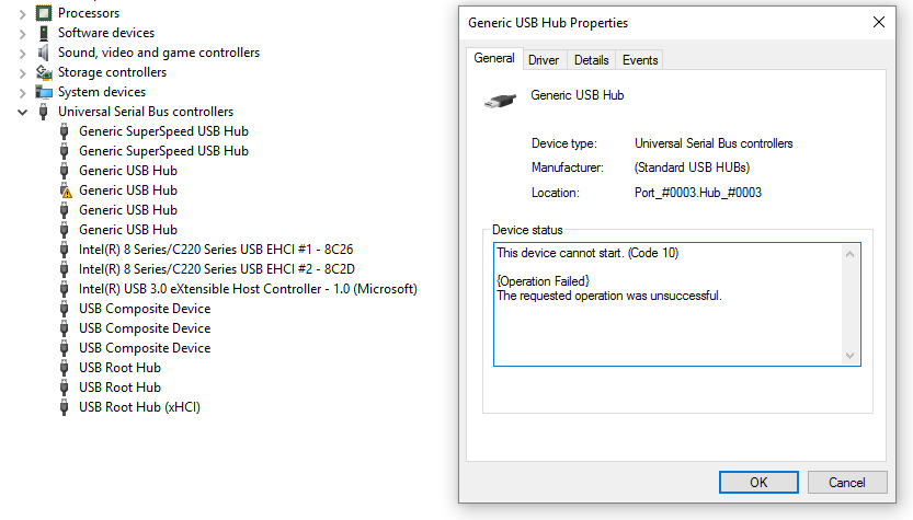

    Looking in Device Manager I got the following error.
    SSD not working on AMD based motherboard USB 3 ports ee604d54-9de6-40df-9dbe-c475293dbfec.jpg
    I tried updating the driver but that didn't help and also uninstalled and reinstalled the driver sadly that didn't help either.
    For now I can move my mouse and TrackIR to the USB 3 ports and I have another 4 working USB ports on the front of my case 2x USB 3 and 2x USB 2.
    Anyone else experience this?

    Hopefully uninstalling the update will fix the issue as it happened after the update.
