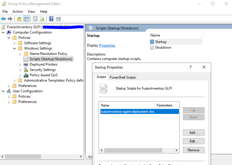

    I'm trying to deply a script using GPO, I've three different scenarios:
    * Workstations wired connected in the office: It works perfectly.
    * Workstations wireless connected in the office: I doesn't work.
    * Workstations at home connected using a VPN: I doesn't work.
    GPO is quiet simple:
    Startup script VPN and Wireless cab923d9-b994-4dc8-bd63-0446537ebb9a?upload=true.png
    The source is a shared accesible folder through wirelees and VPN.

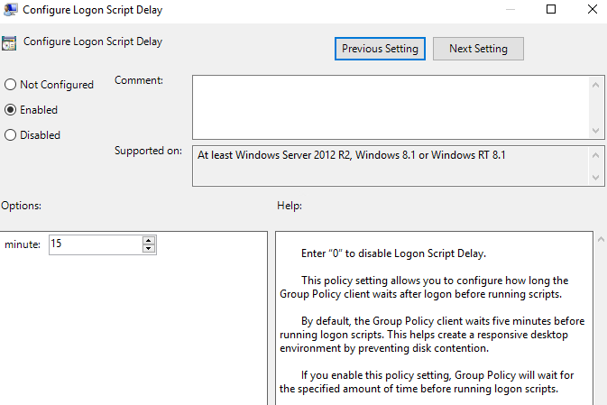

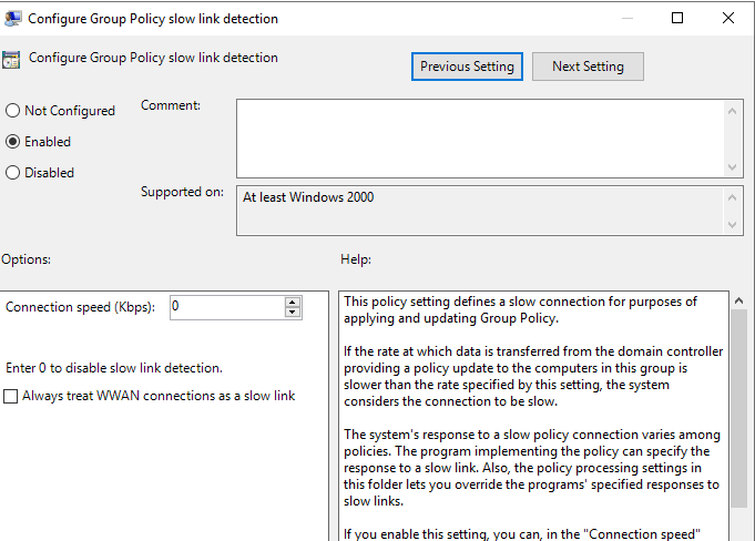

    Also configure this:
    Startup script VPN and Wireless fa1e4eb7-91d6-4400-86f7-612376b3a630?upload=true.png
    And this just to wait until users connect the VPN:
    Startup script VPN and Wireless c6d91c72-423f-4239-835b-53bb05457720?upload=true.png
