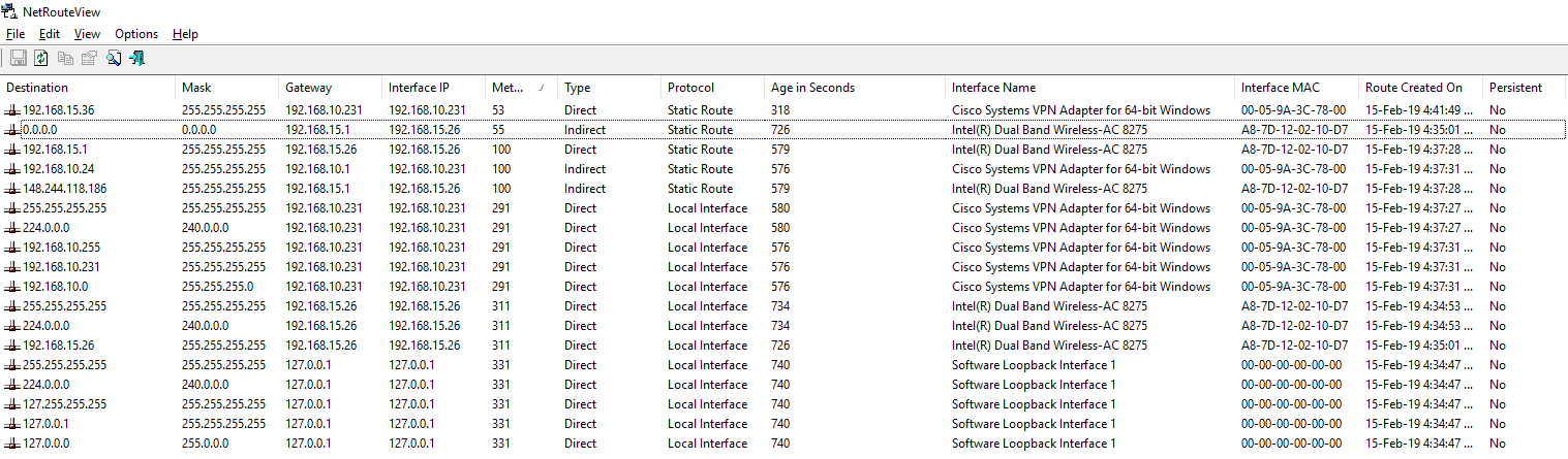

    I connect to a VPN using Cisco VPN which assigns a new interface with the IP: 192.168.10.231
    Now, through the VPN, I need to access an MSSQL database to 192.168.15.36 but it doesn't allow me and it was suggested that I added a static route but it doesn't seem to be helping. These are the current routes that I have:

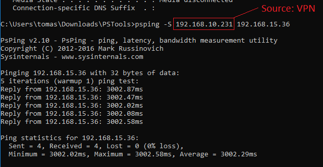

    When using psping I can ping the destination from the VPN Interface:
    How can I setup the routes so that I can access 192.168.15.36 from the VPN interface?
