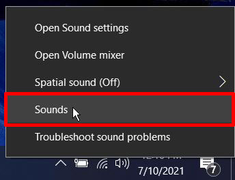

    Right-click on little speaker (bottom right on desktop)
    Stereo sound on OnePlus Buds Z2 not working. 340159d1625948100t-stereo-bluetooth-headphones-do-not-reproduce-stereo-sound-audio1.jpg
    Select Sounds from list

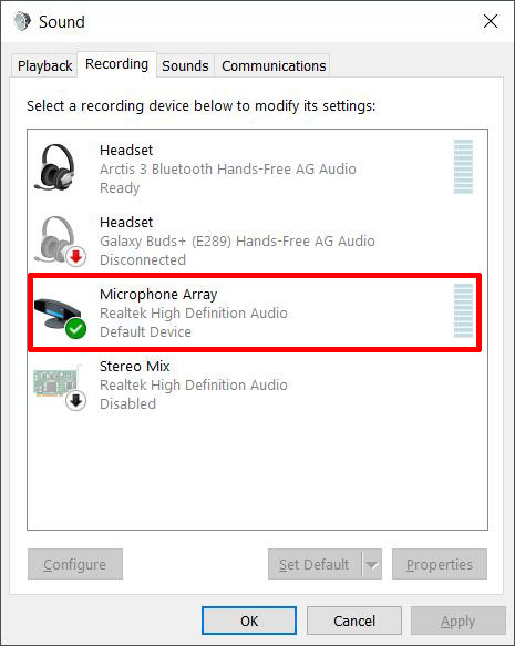

    Select Recording tab
    Make sure Microphone array (or similar) is the current recording device
    Stereo sound on OnePlus Buds Z2 not working. 340164d1625948170t-stereo-bluetooth-headphones-do-not-reproduce-stereo-sound-audio7.jpg

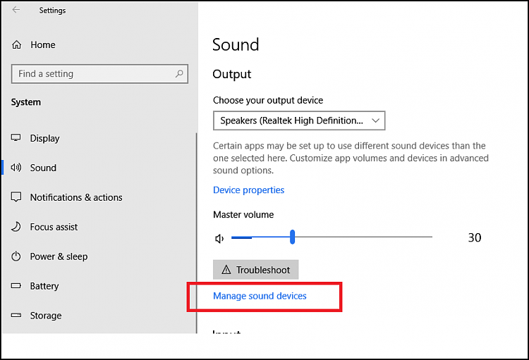

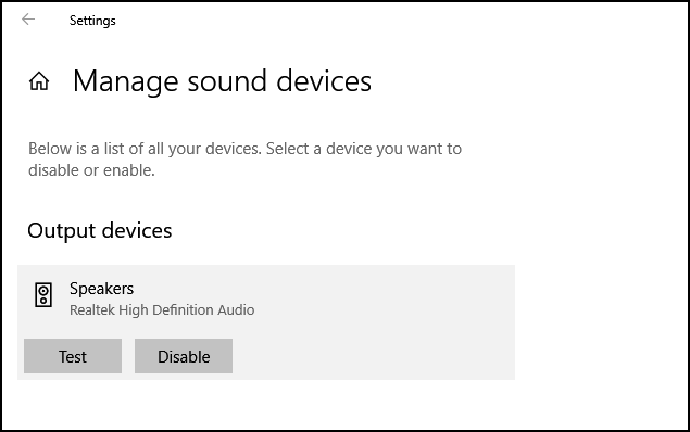

  4. Stereo sound on OnePlus Buds Z2 not working.
    Pairs Pixel Buds A-Series but no sound
    Try "Manage sound devices", and Disable everything, but make sure Pixel Buds are enabled.
