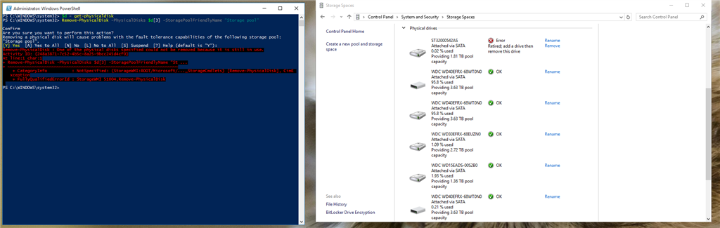

    I have a storage pool that has been working since they were introduced. I have had several failed HDDs over the years and always been able to remove the drive and replace.This time, however, I have a drive that I can't force remove.I have tried several of the Powershell remove commands As admin I don't mind losing this ~1% of data but I just want to force the drive out.Note the optimizing at 99%. It reach that mark in about 24 hour and then stopped. I tried forcing it to stop but that again spent 24 hours doing nothing. I ran a powershell command to restart and this is the current state.It d

  2. Storage Spaces - Unable to Remove Failed Drive / Repair Pool
    Storage Space - Unable to complete removal of a failed drive [​IMG]
    still nothing.
    samsonbiatch, Sep 29, 2021
