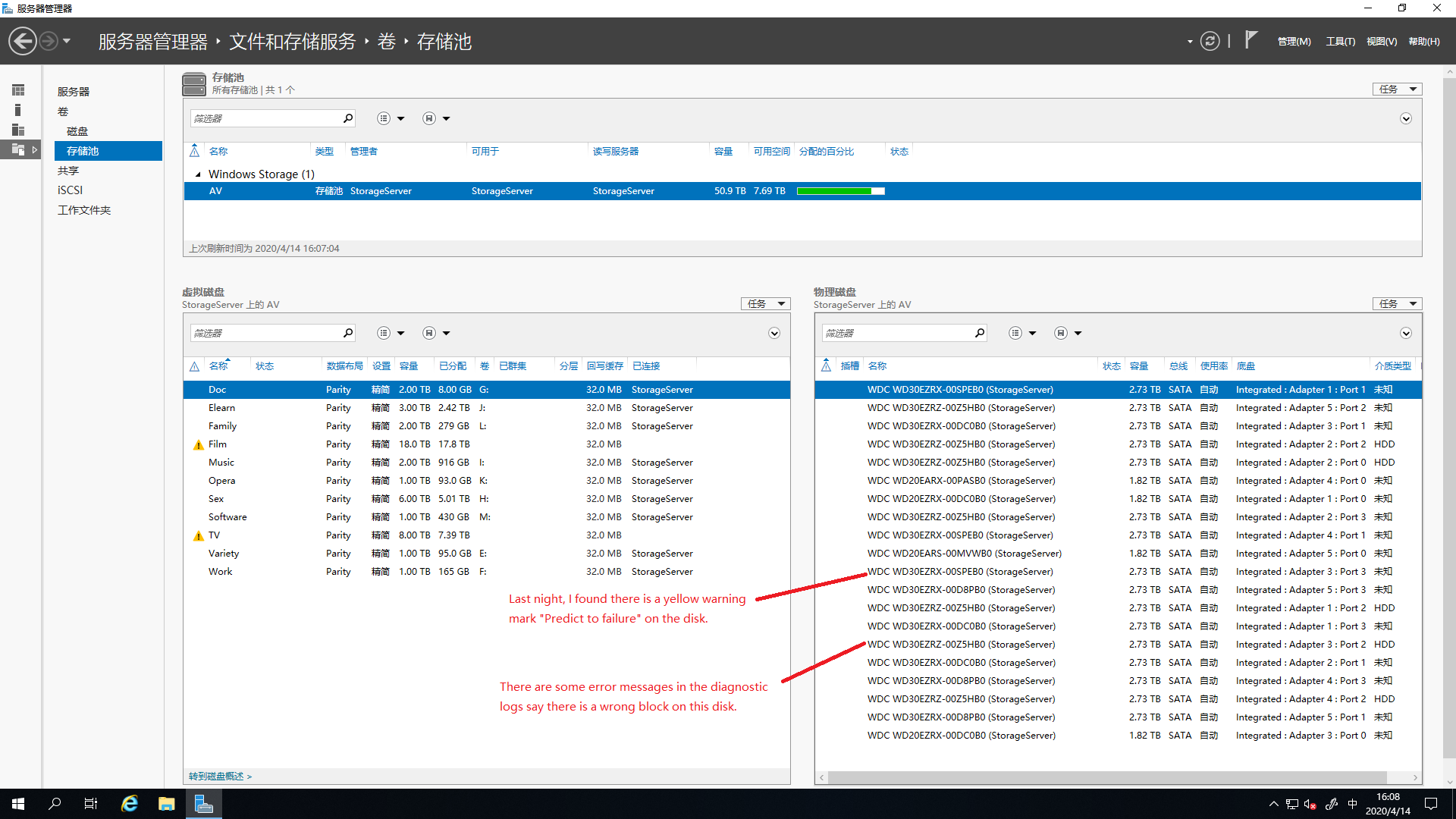

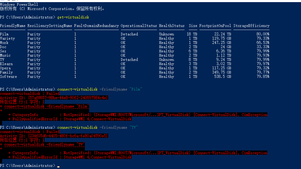

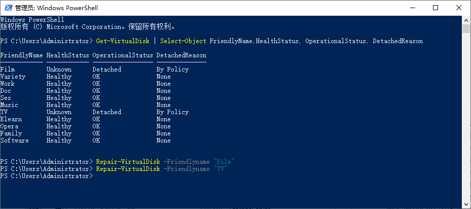

  3. Dean Yang Win User
    Can't connect the VirtualDisk on new server
    When the old server was crashed, I connect all the disks of the StoragePool to the new server (Windows server 2019).
    The StoragePool and all of VirtualDisk can be recognized and no errors found in physical disk.
    However, the two of eleven VirtualDisk can't be connected while the others can be connect properly.
    There was no feedback when running Repair-VirtualDisk cmdlet.
