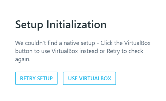

    I have enabled SVM in the BIOS (which is a Gigabyte term for virtualization). I have installed Hyper-V in Windows features.
    I'm running msinfo32 and expect to see four items related to Hyper-V. Instead, I see: "A hypervisor has been detected. Features required for Hyper-V will not be displayed."
    How do I enable Hyper-V??
    PS My goal is to run Docker natively, without VirtualBox. When I try to setup Kinematic, it says:
    Struggling to enable Hyper-V on Windows 10 with AMD Ryzen: "A hypervisor has been detected" E3bVRQE.png
