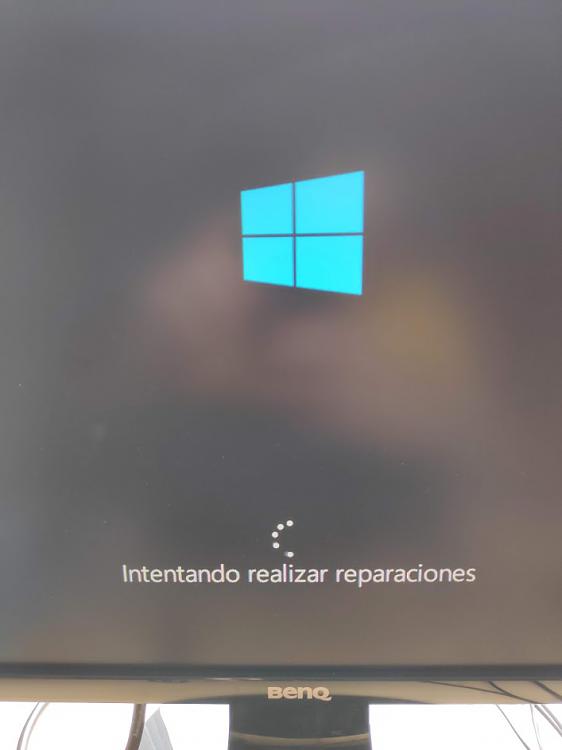

    Stucked in attempting repairs screen when starting up Windows 10
    Windows stuck in "Attempting repair" boot up screen
    No it doesn't stop at the BIOS screen, that only appears briefly but that's normal. The problem comes after that, a black screen with the Windows logo and the loading dots appears, first with a "preparing automatic repair" message, then "diagnosing your PC" and then "attempting repair", and that's where it gets stuck.
    Stucked in attempting repairs screen when starting up Windows 10 284318d1592666367t-windows-stuck-attempting-repair-boot-up-screen-img_20200619_195133.jpg
    (it's in Spanish but that's what it says when it's stuck)
    If I press TAB when the BIOS screen appears it doesn't show any message, only a black screen with white lines of text but it goes away really quickly (I think it's the same that appears when I press DEL to enter the BIOS so I imagine that's the BIOS starting up and not finding anything to show) and then it shows again that Windows "attempting repair" screen, still stuck there.
    Edit: I've read that resetting the BIOS to its default settings could help, and also that I should go into the "Advanced Startup Options" with a bootable copy of Windows, but I want to be very careful with this since I don't know what that does and I don't want to mess up even more. Should I do any of this, could this help?
