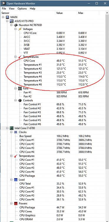

    Thanks. That's one of the monitors I used/have used as it is one of them who reports is absurd non-existing temperature of 112°C. [pic attached]
    Sudden reboot 387874d1679522352t-sudden-rebooting-windows-10-a-open-hardware-monitor.jpg
    as mentioned spot temperature metering does not show anywhere anything warmer then around 40°C it also lists fans that don't exist as I have only 2 additional fans (fan#1 and fan#2) asides from the CPU fan at the PS fan. Both are running automatic regulated and are running at low speeds of around 600 to 900 RPM. Should they ever seize to work an acoustic alert would go off anyway. Those 2 fans mainly create an in-case through circulation, one pushing air into the case the other one pulling it out and have done so for at least 5 years. hence the stable and equal environmental temperatures. The odd thing is, that at least 3 other fans and temperatures are listed that don't exist. Neither by design, physically or otherwise. The problem is, it's a newer thing that started to creep up, of course typically after an update. It seems that a lot of folks out there have the same or similar situation, when you do a "Windows 10 suddenly reboot" search I even spot metered the SSD NVMe, it's pretty much, give or take a couple degrees, the same as reported by the software. I suspect More & more that it is an age related issue with the SSD. but no software reports any indication of such. Here is [an excerpt] what the system reports after a restart from a sudden reboot:

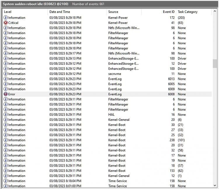

    Sudden reboot 387875d1679524448t-sudden-rebooting-windows-10-a-evt-sys-sudden-reboot.jpg

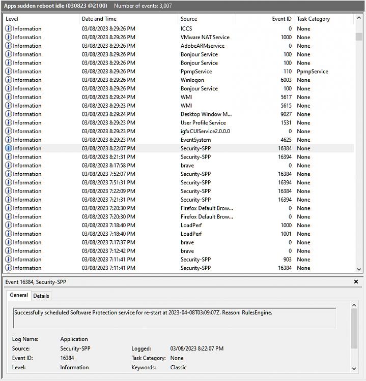

    it takes about 90 seconds or so for the system to reboot hence the restart time off 8:29pm. the app EVT last entry is that 8:22 PM and then the system obviously restarts.

    The sudden reboot onset is as if one would unplug the PS for a couple seconds and then plug it back in again. I doubted it is a PS issue as I also run over a clean sinus stabilized output UPS and the computer is drawing less than 100 Watts. the PS is not even lukewarm, neither the air coming out of it rather a room temperature. I tested the machine and ran it on max load CPU, memory, video and SSD I/O more than quadrupling the power consumption and nothing happened. I think it is The infamous URE "unrecoverable read or write error" on the SSD...
