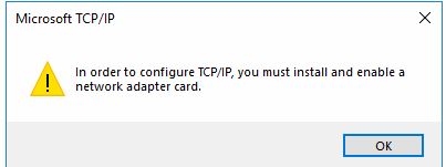

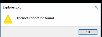

  1. Suddenly my ethernet and adapter vanished after a internet settings reset and i need help
    In short i opened my pc and seen i have no network so i did a reset of the internet settings from the windows settings then suddenly the ethernet adapter and such had vanished i tried a lot of things with cmd but it was useles the cable works cuz i tried it on another device and it did fine also when i restarted the settings turns own nobody near where i live had internet since a cable fell so now i am stuck with no adapter or idea what to do next
    roberto major, Feb 26, 2025

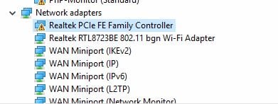

  4. Pantz Win User
    Ethernet adapter keep comming and going in settings
    Suddenly my ethernet and adapter vanished after a internet settings reset and i  need help 192498d1529151218t-ethernet-adapter-keep-comming-going-settings-ethernet-.jpg
    Hello all. i am trying to fix a friends network issue, his laptop is always connected to the wi fi and cannot connect to the ethernet adapter when he used to be able to, i have tried to update the drivers and when i do the adapter then vanished from the settings when i was there originally.
    i have tried changing the ports on the router with no success, there is not realteck adapter in the
    Suddenly my ethernet and adapter vanished after a internet settings reset and i  need help 192496d1529150891t-ethernet-adapter-keep-comming-going-settings-real.jpg
    Suddenly my ethernet and adapter vanished after a internet settings reset and i  need help 192497d1529150891t-ethernet-adapter-keep-comming-going-settings-adapter-.jpg
    removed and reinstalled the network adapter, turned of the wi if he is running win 10 home i am starting to believe that adapter is partially damaged
    Suddenly my ethernet and adapter vanished after a internet settings reset and i  need help 192495d1529149964t-ethernet-adapter-keep-comming-going-settings-tcpip-.jpg
    all suggestions welcomed , Thanks in advance
    Pantz, Feb 26, 2025
