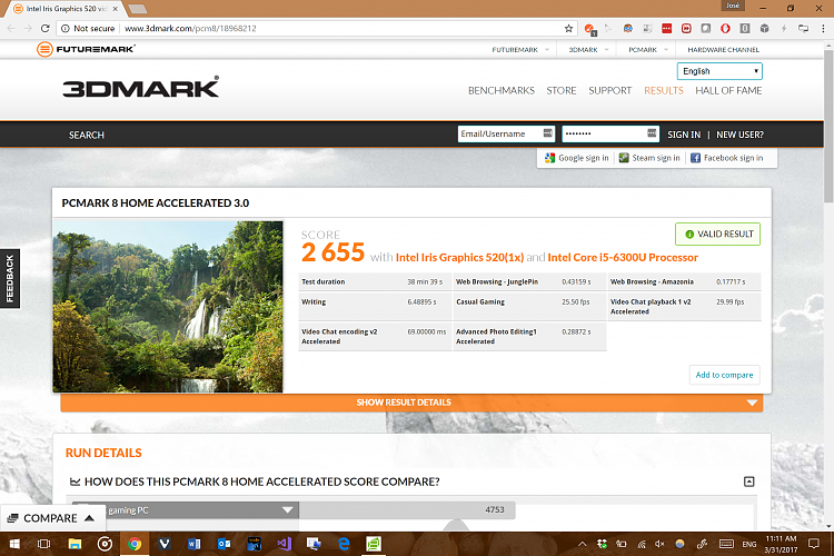

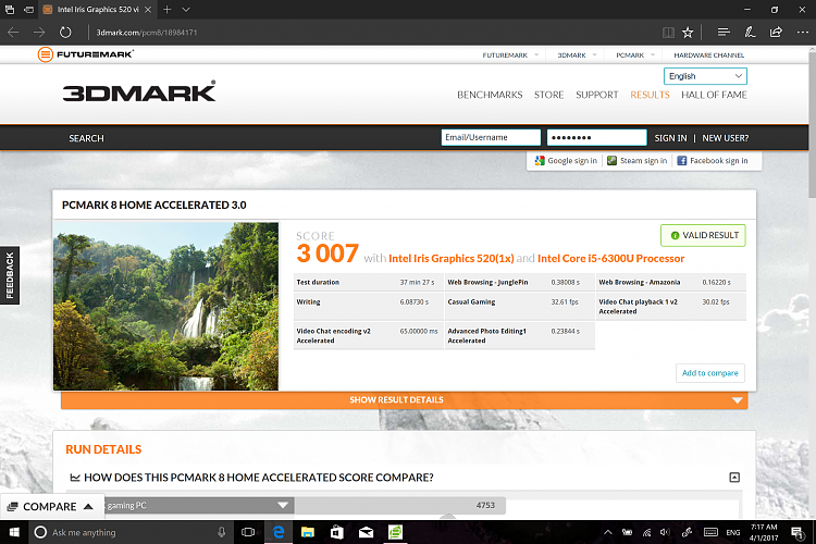

    Hmmm. So I decided to format the computer once more. This time I installed the Creators Update and I can feel it really fast, compared to last time. I downloaded PCMark 8 and made some comparisons.
    This was before formatting:

    This was after formatting:
    Surface Pro - Intel Core i5 / 128GB SSD / 8GB RAM - freezes 127560d1491045907t-slow-performance-surface-pro-4-core-i5-8gb-screenshot-1-.png
    A 13% difference!!!
    The formatted part was running Vanilla Windows 10, that means that I haven't installed a single program into it.
    I'm going to start by installing Office and Dropbox, and I will run the test again to see how it goes.
