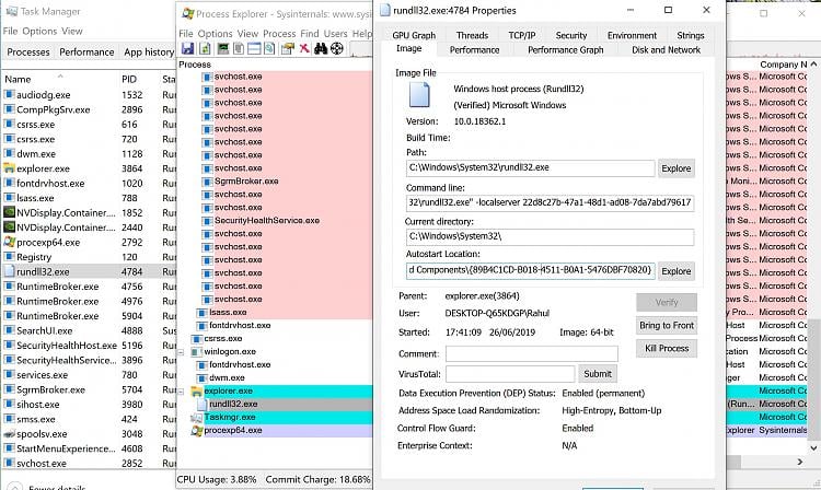

    From the last few days there is something bizarre happening with my Windows 10 Task Manager Rundll32.exe will start running in the background when I look at my Task Manager and will not disappear.
    I have Windows 10 1903 for the last 1 month and I never noticed this, until a few days ago.
    Suspicious "rundll32.exe -localserver ***" running in Task Manager, possibly a network worm 8457d1561568865t-what-rundll32-exe-why-has-started-running-background-rundll32.exe-after-2-hours.jpg
    I'm completely confused as to what this is. It starts launching approximately after 2 hours and will remain there. This happened somewhere around the 18th of June.
    "C:\Windows\system32\rundll32.exe" -localserver 22d8c27b-47a1-48d1-ad08-7da7abd79617
    Autostart location. HKLM\SOFTWARE\Microsoft\Active Setup\Installed Components\{89B4C1CD-B018-4511-B0A1-5476DBF70820}
    I tried searching for this but I couldn't find much info. I think I started noticing this after I installed Diablo 2 and Splinter Cell 1 on the 18th of June. But I don't know if this is simply a coincidence. But it definitely seems a little bit strange as I have not noticed this behaviour prior to that.
    Can someone tell me what is triggering this to launch after 2 hours?
