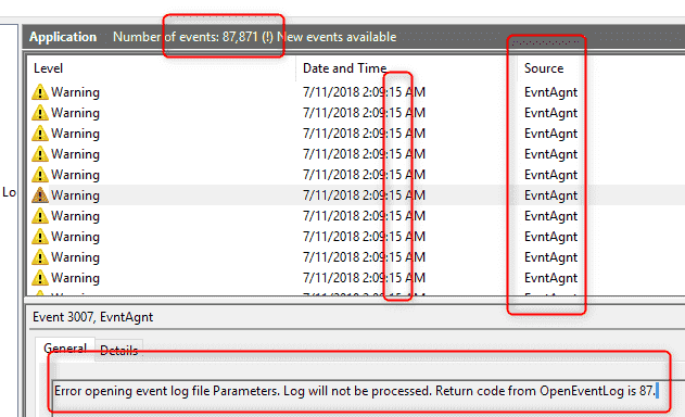

    The Service Host: Windows Event Log is using much of my CPU and I believe the issue is that its constantly generating the same event over and over. Going into event viewer, I'm finding that every second tens of thousands of identical copies of the same event are being generated, to the point where they're being overwritten as quickly as they're generated, as the events instantly surpass my maximum log size.
    This is the event in question:
    Event 3007, EvntAgnt
    Error opening event log file Parameters. Log will not be processed. Return code from OpenEventLog is 87.
    Log Name: Application
    Source: EvntAgnt
    Event ID: 3007
    Level: Warning
    User: N/A
    Task Category: None
    Keyword: Classic
    I've not been able to find any help topics on this particular error, and the various help tools haven't helped either.

    You guys aren't answering his question or even reading it for that matter. It doesn't matter what svchost is, the event log clearly states what the service is and so does Task Manager. I'm having the same exact problem.
    I have been for a couple weeks now, it happens pretty constant when it does start (I don't notice it so much earlier in the day). My event log also has thousands of new entries PER SECOND added - which is pretty clearly the cause of the high CPU usage.

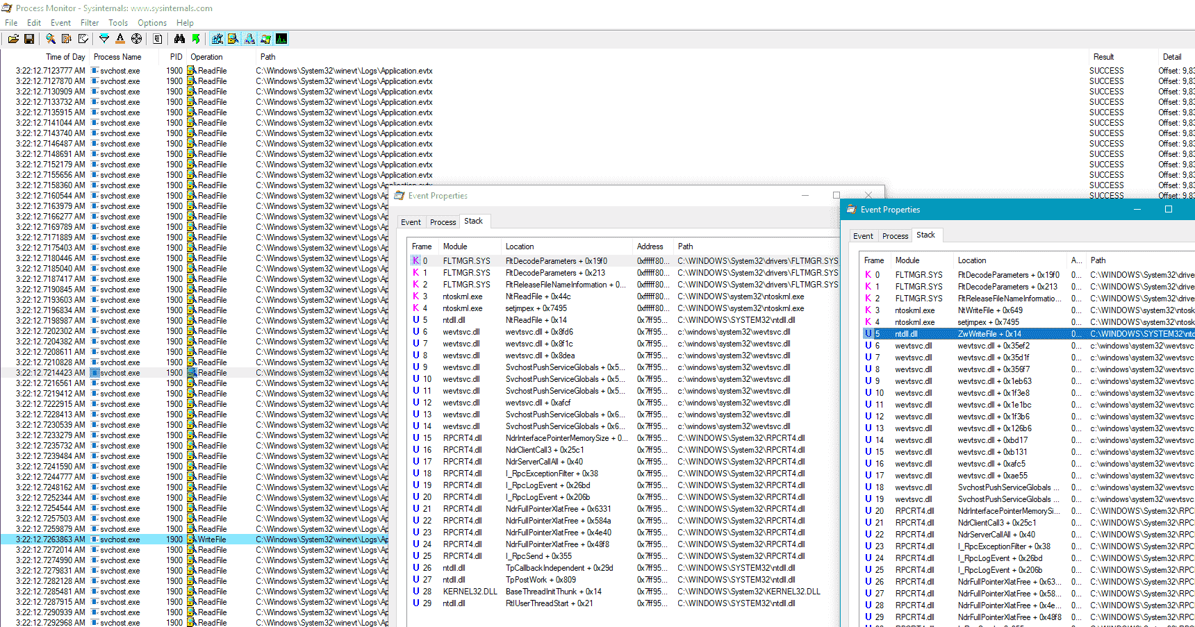

  6. Adam P New Member
    Running ProcMon I can see what seems to be hundreds (or thousands) of READ operations against the event log file between each of the writes. Included screenshot
    svchost.exe is causing system slowdown due to repeating warning; Source: EvntAgnt, Event... upload_2018-7-11_3-34-52.png
    The right window is a stack trace of a write operation and left is a read operation. Looks like it's something in the filesystem filter
