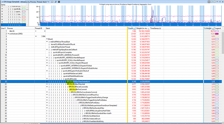

    Here is my analysis of the trace file;svchost.exe (2992) process is using 12 % of the CPU. The process call stack shows functions calls from BFE.DLL module !
    svchost.exe Service Host: Network Service using all my net connection! 173594d1516541744t-svchost-service-host-local-service-no-network-cpu-10-15-usage-capture.png
    BFE stand for Base Filtering Engine Service. it's a service that controls the operation of the Windows Filtering Platform (WFP). WFP is a network traffic processing platform that allows software to “hook” into Windows networking stack and perform such functions as firewall, traffic shaping, filtering, etc.
    The svchost is doing this job for another process who called it. for that I'll use the CPU precise graph to see which process redied the most our svchost process. this process is probably at the origine of this CPU activity !

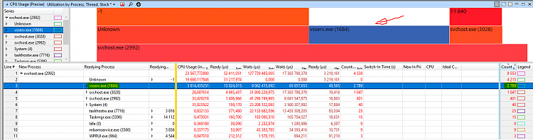

    svchost.exe Service Host: Network Service using all my net connection! 173595d1516541835t-svchost-service-host-local-service-no-network-cpu-10-15-usage-capture1.png
    You can see that the vsserv.exe process (Bitdefender) makes the svchost process ready to run 2789 times.
    To be sure it's Bitdefender the culprit, do the following;
    1. disable the Bitdefender firewall and see if the cpu activity decrease;
    2. If not; disable all bitdefender application and see if it helps;
    If you confirme it's Bitdefender, then you can update to a newer version. Otherwise, unistall it and re-install it again ...
