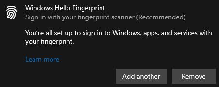

    Hi Rajesh,
    We understand that you are unable to use Windows Hello Fingerprint to sign in to Windows. It would be great if you can reply with the details requested below:
    • When you say, “I am not getting the option to log-in into windows using fingerprint.” What login options do you see on the login screen?
    • What happens when you try to use the Windows Hello Fingerprint scanner to login to Windows?
    • Were you able to use the Windows Hello Fingerprint to login to Windows earlier?
    Ideally, on the login screen, you will see Sign-in options that allows you to use different sign-in methods to login to Windows.
    As you have mentioned that you are able to use the Fingerprint scanner on websites, I would suggest you to refer the steps mentioned below and see if that helps:
    1. On the login screen, click on Sign-in options.
    2. Click on the Fingerprint icon, scan the Fingerprint, and see if you are able to sign in.
    Refer the screenshot below:
    Synaptics Fingerprint added in the settings but Fingerprint option not Showing on Lock Screen fc087693-5104-47d8-960f-4d6097885918?upload=true.jpg
