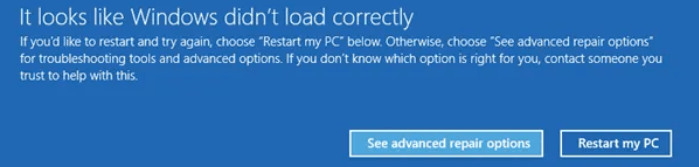

    Option 1) Let it fail until it attempt to automatic repair and when you see this screen select Advanced repair options to enter repair environment.

    Option 2) When OS start boot and you see those spinning dots push power button to force power off, on third boot it will open repair environment.
    When you are in repair environment follow these instructions to boot in safe mode.
    PCIe SSD not booting after cloning from SATA SSD/HDD | Crucial.com
    This will install correct NVMe driver and boot to screen asking user name and password. At that point do not enter anything, just use power button on lower right cornet on screen to restart. Now it should boot normal mode and you can sign-in.
