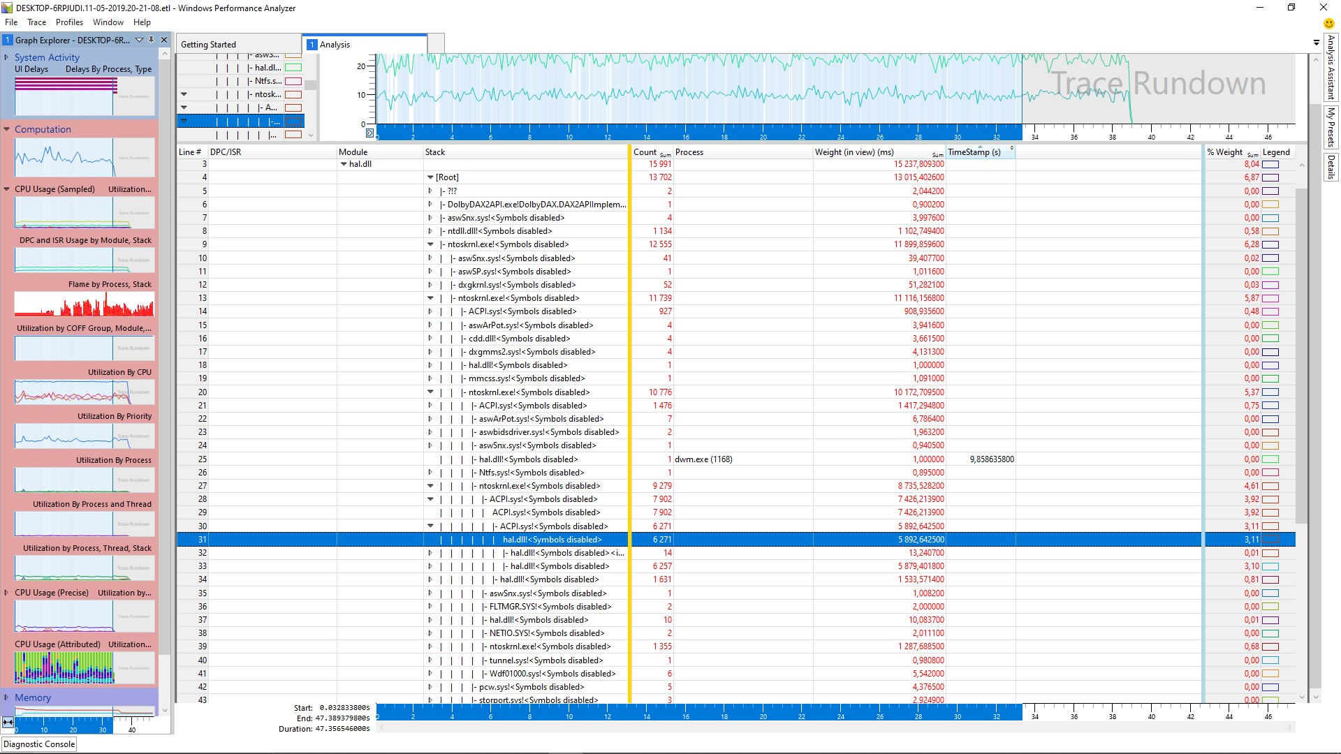

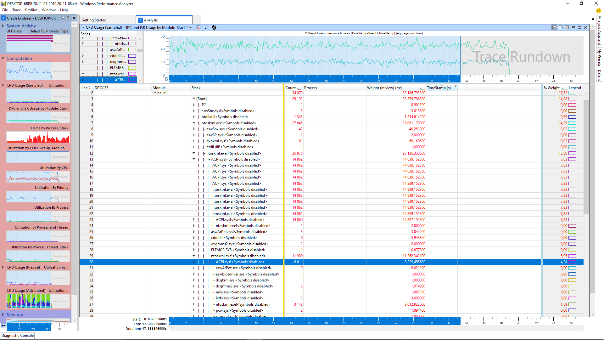

    I am at my witz end, took my sweet time on google trying to find what is wrong with pc i bought second hand. The computer in question is:
    https://www.amazon.com/d/All-One-Computers/Lenovo-IdeaCentre-Touchscreen-Desktop-i5-6400/B01MQUV5UA
    I did clean instalation, downloaded new drivers, got few basic programs and downloaded steam and games. Noticed sluggish performance and saw that System interupts chew trough one core alone.
    Fixes i tried:
    1) Delete and reinstal of graphics drivers (nvidia and intel)
    2) Turning off waking up with magic packet.
    3) downloading and instaling Intel rapid technology for drives
    4) turned off audio enhancements
    5) turned off fast startup
    6) unplugging all usb periferials.
    Tried windows performance recorder and analyzer combo it seems that hal.ddl is hogging all the resources.
    Recorded 30s of CPU usage: https://drive.google.com/file/d/1ouduBzuDPKkeD9T4MFxQl_ZvtFjVlIBz/view?usp=sharing
    Relevant screenshots.
    System interupt pernamently around 15-25% affe87ff-0d04-484b-b1c7-01523082e2a6?upload=true.png
    System interupt pernamently around 15-25% 99ac06dc-5d0e-4121-8c8e-af1065d3be28?upload=true.png
