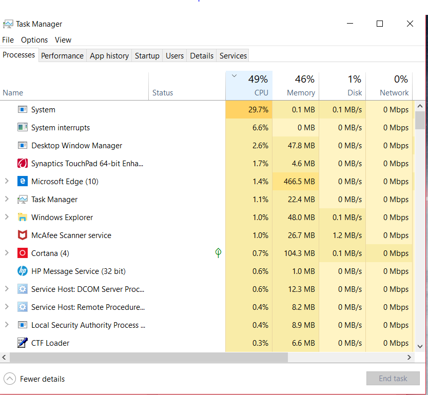

    Hello All,
    For some reason the CPU usage by System process is always at 30%.
    It never goes down, Even if I reboot the system the usage will stay normal some time and then the system Process will start using the CPU at 30% again.
    My laptop Model is HP OMEN CE073TX
    OS - Windows 10 Pro 1903
    Here's what I did so far.
    1.Updating Windows, BIOS and all drivers to latest version.
    2. Ran DISM /Online /Cleanup-Image /CheckHealth, DISM /Online /Cleanup-Image /ScanHealth, DISM /Online /Cleanup-Image /RestoreHealth commands. Did not find any issue with system files.
    3. Ran SFC /Scannow command, No issue with system files again.
    4. Performed hardware diagnostics and did not find any issue with Hardware.
    5. Used reset this PC option to reset the Windows 10.
    6. Used the Default USB recovery Image provided by HP to re-image the laptop.
    7. Used the latest version of ISO from Microsoft to re-image the laptop.
    But despite doing all the steps the system process 30% CPU usage never seems to go away.
    Highly appreciate any help regarding this issue.
    Thank you!

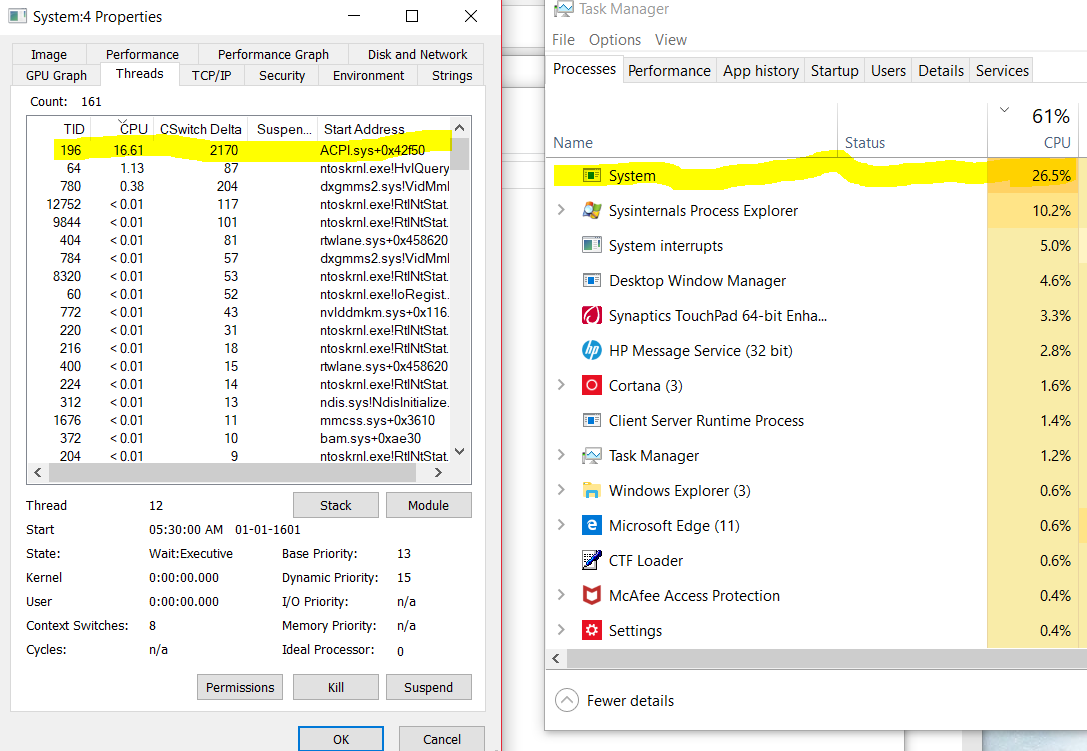

  4. NoNameRO Win User
    System process always uses 30% CPU.
    ACPI.sys using 30% CPU
    The process system is constantly taking 20% to 30% of my CPU.
    I've checked with the Process Explorer, it indicates that the cpu is taken by ACPI.sys.
    I've tried most of the solutions I could find with no success.
    Now, I've basically reinstalled this machine from scratch because of the issue but even after a clean re-setup the issue hasn't gone away.
    The weirdest part of this is that if I put the computer to sleep and then wake it up, the System process goes back to a normal CPU usage but if I restart the computer then it's back to square one with ACPI.sys going over 30% CPU
    How can I fix this?
