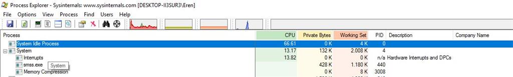

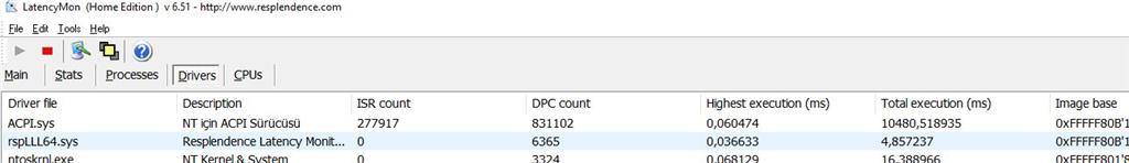

  2. erenesto Win User
    ACPI.sys always using the CPU like 15% - 20%
    • Are you using a particular program when you encounter the issue?
    - No, i saw it on Task manager. It's System. Always using 15% - 20% CPU. I just look with LatencyMon and Process Explorer. You can see on screenshots.
    "System" process using 15-20% of CPU 7700 HQ. 237f3b4a-690d-49bf-bbf7-2c9f328d9ae9.jpg
    "System" process using 15-20% of CPU 7700 HQ. 5ce1ee67-db98-416b-9b82-b47bf0bf641c.jpg
    "System" process using 15-20% of CPU 7700 HQ. 22cee142-4b67-4719-97f2-3c989685e618.jpg

    I found
    this article
    on here about Windows performance recorder and i applied that steps. I added my .etl file in my first message as you can see.
    I'm waiting your helps.
    Thanks.
    erenesto, Jul 11, 2018
