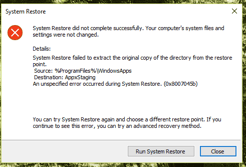

    Windows 10 Home, tried several times to system restore using methods from this question.
    System Restore Error 0x8007045b d813badc-823e-4ca8-908f-bb4abc375a99?upload=true.png
    I used cipher /u /n/ h to check for encrypted files, found some from a game from the Microsoft Store which I uninstalled. Still cannot system restore. Tried restoring from RE but got error 0x80070026 instead.
    Also gave myself full control over the WindowsApps folder, but that hasn't seemed to help either.
    Any thoughts/solutions?

    Based on the details that have shared on your post, it seems that you have already identified why the error occurs when you are attempting to perform a System Restore. Having said that, we would like to verify if you have tried the initial troubleshooting
    steps suggested in this article: System Restore may fail with error code 0x8007045b if
    there is encrypted content in the restore point
    . Kindly advise us if the solution works or if you have also encountered a different error code so we can provide additional help.
    We'll wait for your response.

    System Restore Point errors: 0x8007045b and 0x80070057
    Hi, see
    https://support.microsoft.com/en-gb/...-restore-point
    The exact error message is significant to determine whether this is relevant or not.
    Compare:
    System Restore
    An unexpected error occurred during System Restore. (0x8007045b)
    (I simply searched for
    system restore 0x8007045b
    dalchina, Aug 7, 2018
    System Restore fails with error code 0x8007045b
    I've been trying to run the reagentc /boottore
    But it fails as it seems it wants to connect to Azure for some reason, to get som product code...
    I do have AoE Beta installed and these are encrypted according to the cipher command as per OP.
    Any ideas how to get restore to work?
    Vidfamne, Aug 7, 2018
