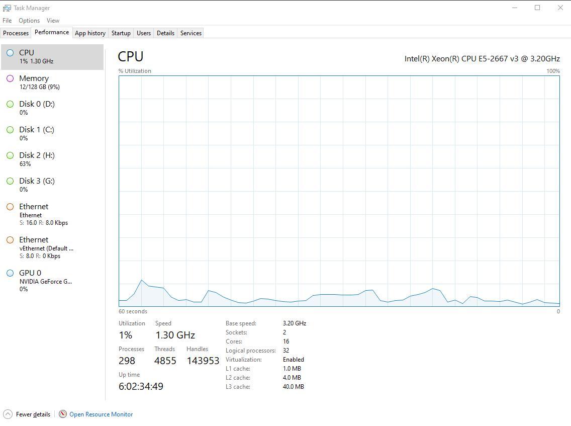

    Task Manager:
    Task Manager, Net Statistics Workstation, etc all show wrong time of when system started! eef1ee5c-abb4-4341-a433-365f1b9b620d?upload=true.jpg
