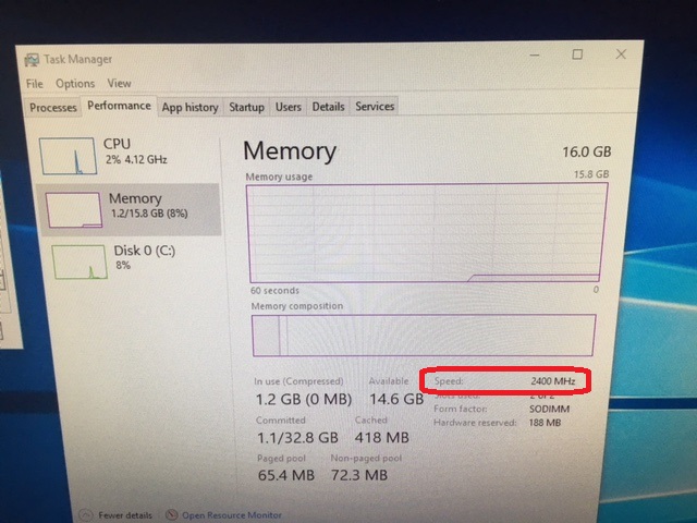

    Memory speed might be wrong in Task Manager
    I guess the speed is from Speed of SMBIOS Type 17, but Speed of SMBIOS Type 17 Identifies the
    maximum capable speed of the
    device, but I think we shoud get from Configured Memory Clock Speed of SMBIOS Type 17, it's the configured clock speed to the memory
    device.
    If there are two memory slots in my system,
    I plug 2400MHz in the slot 1 and 2166 in the slot2, the memory speed shows 2166MHz in Task Manager.
    I plug 2166MHz in the slot 1 and 2400 in the slot2, the memory speed shows 2400MHz in Task Manager.
    Microsoft shows the memory speed which is from the speed (Identifies the maximum capable speed of the device) of the
    last SMBIOS Type 17 Memory Device.
    Task Manager showing Wrong base speed 5cf62451-6ad8-48d6-8dd7-24b28c28719b?upload=true.jpg
    Thanks
    WilsonLee512, Apr 30, 2022
