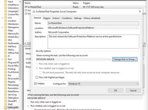

    OK, the next step in trouble-shooting is to examine your task. Please do this:
    1. Right-click the task, then export it to an .xml file.
    2. Open the .xml file with Notepad.exe.
    3. Copy its contents into your reply.
    Frederik Long, Feb 4, 2021

    Unexpected Ghost task detections
    1 The problem
    Strangely-named and seemingly inexplicable entries have been seen in the Task scheduler, Task status pane and they do not even record a Triggered by entry that would allow them to be investigated.
    I’ve taken to referring to these tasks as ‘ghost tasks’ merely as a convenience, a shorthand title.
    Task SvcRestartTask: The task XML contains an unexpected node [​IMG]
    No corresponding task definition can be found anywhere within Task scheduler or in any of its configuration folders -C:\Windows\System32\Tasks,
    C:\Windows\Tasks,
    {not confirmed} %SystemRoot%\SysWOW64\Tasks
    The only other place that refers to these Task status pane entries is the Event viewer, Task scheduler log which refers to them as JD_TaskSchedulerSchedule tasks.
    The Task scheduler, Task status pane entry & the Event viewer entry both refer to this particular task as {429ce28d-4d24-48c8-914a-8605598c50c8}.
    Further instances of the Task scheduler, Task status pane entry have different reference codes [GUIDs] - each of which is always matched by an Event viewer entry.
    The TenForums member Andy Bruin has investigated these ‘ghost tasks’ and has identified
    - the Windows mechanism that causes them to be shown in the Task scheduler, Task status pane, and
    - a method of suppressing them.
    Reassuringly, these ‘ghost tasks’ appear to be the result of Windows internal mechanisms [rather than malware] and do not appear to be doing anything at all.
    The jury is still out about whether the existence of these ‘ghost tasks’ is inevitable or requires some particular originating trigger that remains unidentified. I believe that there is an unidentified trigger -- Several users have observed the existence of these ‘ghost tasks’ but many others have never had them.
    - A user who used to suffer from ‘ghost tasks’ has reinstalled Windows and no longer has them. This user knows what to look for in Task scheduler & Event viewer. If the existence of ‘ghost tasks’ was inevitable, they would have returned on that user’s computer after Windows’ reinstallation.
    2 Purpose of the GhostTaskSuppressor
    The purpose of the GhostTaskSuppressor is to scan for, detect & delete the immediately-preceding cog in the ‘ghost tasks’ mechanism so that they never start.
    This GhostTaskSuppressor tool both includes and builds upon Andy’s suppression method.- Andy has done all the clever work.
    - All I’ve done is wrap it up into a package that can run in the background without bothering the user [unless, optionally, the user chooses a notification option].
