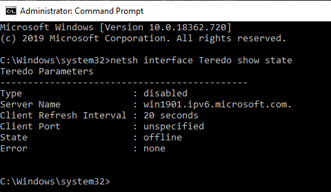

Discus and support Teredo is unable to qualify in Windows 10 Network and Sharing to solve the problem; [ATTACH] I already tried everything here : https://beta.support.xbox.com/help/Hardware-Network/connect-network/troubleshoot-party- chat I really... Discussion in 'Windows 10 Network and Sharing' started by SharonElfassi, Apr 1, 2020.

    • Right click the Windows icon on the taskbar and choose Windows PowerShell (Admin).
    • Copy and paste the following command and hit Enter:
      Get-AppxPackage Microsoft.XboxApp | Remove-AppxPackage
    • Reboot the computer once the command is executed.
    • Once the machine restarts, launch Microsoft Store and reinstall the Xbox app.
    After reinstalling the Xbox app, open Windows PowerShell (Admin)
    again and copy paste the following command to enable Teredo.
    netsh interface Teredo set state type=default
    Let us know how it goes.

    I understand that you are facing issues while playing games as Teredo is unable to qualify. For further clarity on the issue, please respond to the questions below.

    In addition, as you have mentioned that Norton is blocking a port which is being used by Teredo adapter, I would suggest you to try disabling the antivirus and check if the status changes.
    Note: If you disable the security software or firewall, the system might be temporarily exposed to security threats and risks. Please make sure to turn it on after performing the steps.
    You can also create an exception in Norton for the ports, refer the article
    Use the Add Rule wizard
