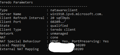

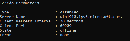

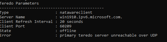

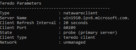

    Hi There,
    For the last while I have had an issue where I am unable to play any games from the Xbox app on my windows 10 PC. I keep getting the error Teredo is unable to qualify. I have looked up guides and tried to fix this but I have had no luck. When I look in CMD and run the command netsh interface Teredo show state I seem to get 1 of 4 things come up, I will post the pictures the pictures of the errors below. Sometimes it seems to be working fine but 2 mins later is has lost connection again. If anyone has a fix for this I would be extremely grateful because since it is so unreliable I cant play any Xbox games which are multiplayer.
    Many Thanks,
    Jacob
    Teredo is unable to qualify f9c711e3-5b39-43d1-b770-c9af4e0ccb61?upload=true.png Teredo is unable to qualify 2737601a-cba0-4931-8a37-f8be497f7bed?upload=true.png Teredo is unable to qualify af76fde6-9e5f-4c84-8448-4ad3e95be8bd?upload=true.png Teredo is unable to qualify 26cc393f-2337-4c03-8b2e-d0892f4e4a4b?upload=true.png
