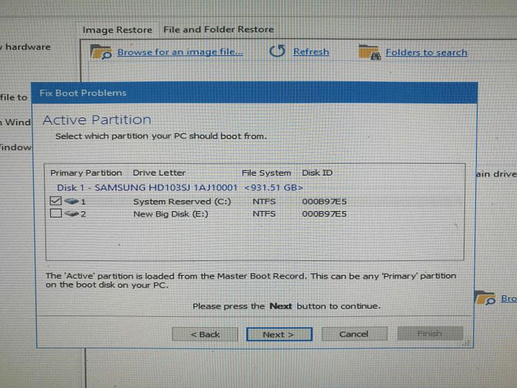

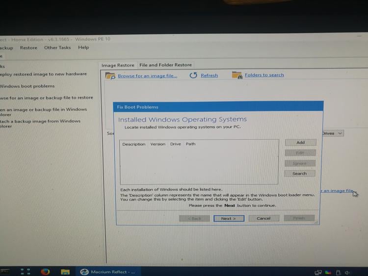

    I followed your instructions but Macrium could not find an operating system. See image below.
    The boot configuration data for your pc is missing and contains errors windows 11 157500d1507735833t-boot-configuration-data-your-pc-missing-contains-errors-fix_boot_problems_1.jpg
    I pressed next anyway and selected C: and pressed next again.

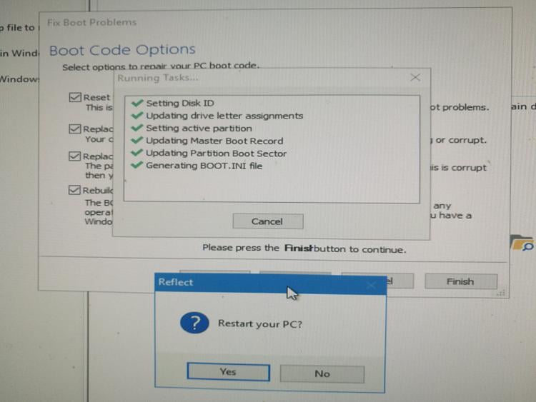

    The boot configuration data for your pc is missing and contains errors windows 11 157499d1507735833t-boot-configuration-data-your-pc-missing-contains-errors-fix_boot_problems_2.jpg
    I ran the fix and everything seems to have worked fine. I then restarted my computer.
    The boot configuration data for your pc is missing and contains errors windows 11 157498d1507735833t-boot-configuration-data-your-pc-missing-contains-errors-fix_boot_problems_3.jpg

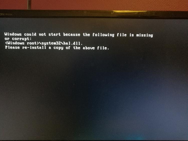

    I was greeted with a new error *Sad
    The boot configuration data for your pc is missing and contains errors windows 11 157497d1507735833t-boot-configuration-data-your-pc-missing-contains-errors-new_problem.jpg
    Any idea on what to do next?

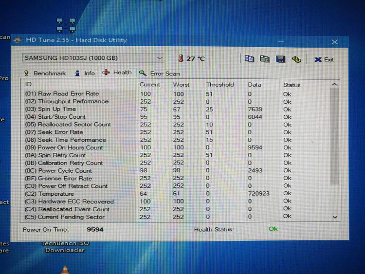

    To dalchina.
    Here's the result from the HD Tune Health tab.
    The boot configuration data for your pc is missing and contains errors windows 11 157502d1507736327t-boot-configuration-data-your-pc-missing-contains-errors-hdtunehealth.jpg
    I am currently doing an error scan with no damaged blocks after 15 minutes. I will leave it on and come back later and post the result.

    So to summarize I currently have this error when trying to boot my computer.
    Windows could not start because the following file is missing or corrupt:
    <Windows root>\system 32\hal.dll.
