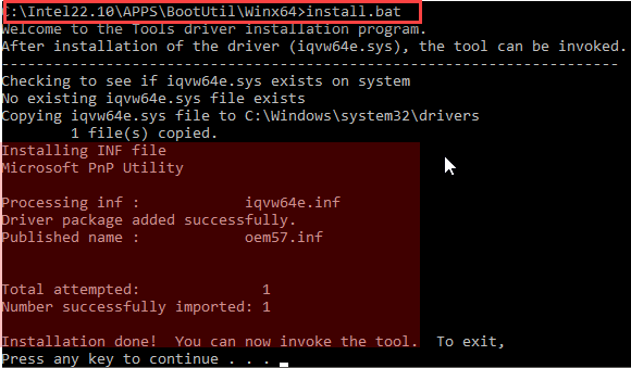

    • If you receive the error to reinstall a missing or corrupted driver when attempting to run this command; within command prompt, navigated to the same directory of ...\Intelxxxx\APPS\BootUtil\Winx64\, type in the following command:
      • install.bat
        • This will effectively install the necessary driver to use this specific utility correctly (all of its intended features). You may then re-run the original command specified in the above steps.

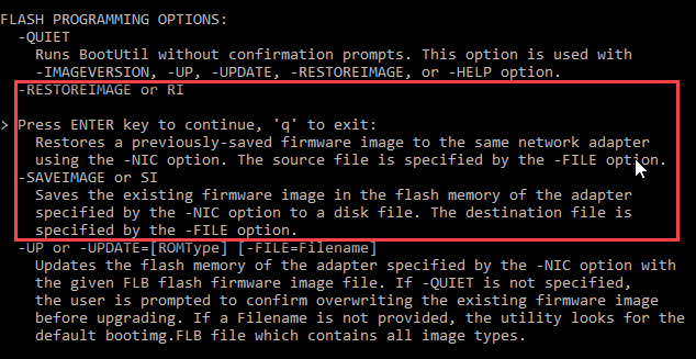

    If you're STILL getting issues with the adapter after performing either fix in Windows or Linux, you may need to save the working configuration of a known working computer that has the Intel I218-LM adapter to USB media, then restore
    the saved configuration to the affected adapter:
    The device cannot start Code 10, Intel Ethernet Connection 14 l219-LM 0a67ca0a-3958-45d2-8f96-3655e0904520?upload=true.png
    Type in "bootutilw64e.exe -HELP" within command prompt to see the list of commands/triggers available and details for each command/trigger.
