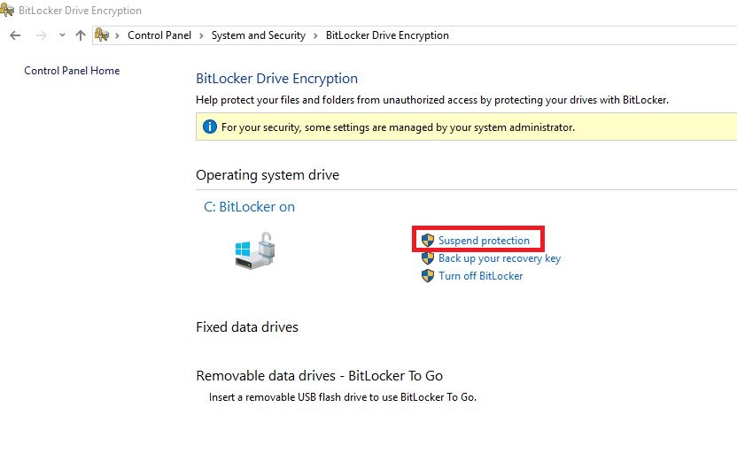

    If the solution provided didn't resolve the issue, and you really need to update the BIOS, please see the steps below on how to suspend the BitLocker:
    • Press Windows key. Type Control Panel, then hit
      Enter.
    • Select System and Security.
    • Select BitLocker Drive Encryption.
    • Select Suspend Protection.
    • Once the BitLocker is already suspended, you may proceed with the BIOS update.
    Note: You don't have to turn off the BitLocker to update the BIOS, you may just suspend its protection.
    The latest BIOS update on my laptop turned on BitLocker -This seems like a production bug? 5f2ac66f-d7bf-4f09-b5ff-d53c94556569?upload=true.jpg
    Please post back with the result for further assistance.
