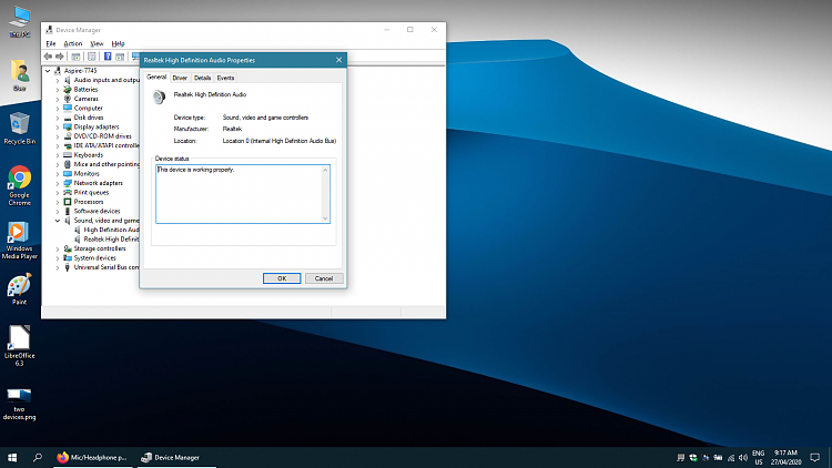

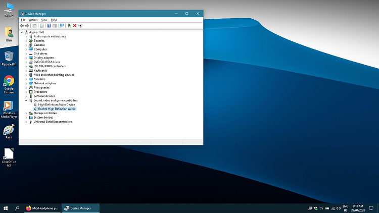

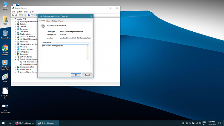

    One odd thing I neglected to mention - the computer lists TWO sound devices. Installing drivers only seems to change one of them so that is the only one I've been directly playing with (the one at 'Location 0'). If I delete both from Device Manager, Windows auto-reinstalls two again...?
    The mic of my  acer aspire 5 stopped working 276483d1587990072t-mic-headphone-ports-not-working-correctly-acer-aspire-7745-a-two-devices.png

    The mic of my  acer aspire 5 stopped working headphone-ports-not-working-correctly-acer-aspire-7745-a-location-3-high-definition-audio-device.png

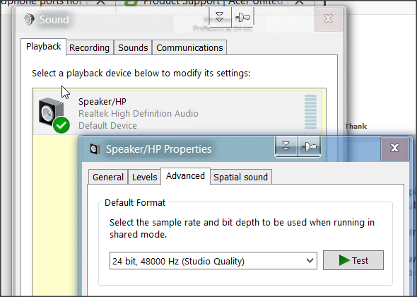

    Have you played with these settings and checked the green bars move when you click Test?
    The mic of my  acer aspire 5 stopped working 276769d1588164063t-mic-headphone-ports-not-working-correctly-acer-aspire-7745-a-1.png
    Also that the correct default output device is selected, of course.
    Also that nothing's muted in the Voume Mixer that shoudn't be.
