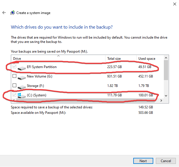

    The read operation from the volume shadow copy on the source failed. (0x80780029) when trying to create system image
    I'm trying to create a system image, as I've gotten a new SSD and want to use the image to save time on backing up specific files, programs, settings, etc.
    However, when I try to create a system image I get the following error:
    The backup failed.
    Additional Information:
    STATUS_WAIT_1 (0x80070001)
    Now, I've tried troubleshooting this problem through quite a few various methods from looking around at people having the similar issue.
    I'm not 100% sure if this is the problem, but I'd like to eliminate it as a possibility. But, it seems my OS and my EFI System Partition are on different drives. I'm not entirely sure how this happened.
    The read operation from the volume shadow copy on the source failed. 0x80780029 when trying... ea6d4cc0-d174-47c5-9ee5-56a0a8d4bf18?upload=true.png
    As you can see in this image. My OS is on a 120GB SSD and for some reason my 240GB SSD just seems to be one big EFI System Partition. To test this I removed my 240GB SSD and tried to boot just from the C: drive and received a BCD error upon bootup, so I'm
    guessing the important boot files are on the 240GB SSD and not on my C: drive. Could this be what's causing me issues during the system image backup?
    I have tried relocating the EFI partition to my C: drive but that doesn't seem possible as I cannot partition the drive without formatting it.
    So I figured the next best thing would be to see if I could just get my C: drive to boot without the need of the other drive, so I can keep the other drive unplugged and run a system image backup to see if I still receive errors.

    Any insight or anything else I should try? Am I just out of luck from messing up my EFI System partition?
    Thanks for your time!
    JustinCM, Apr 21, 2025
