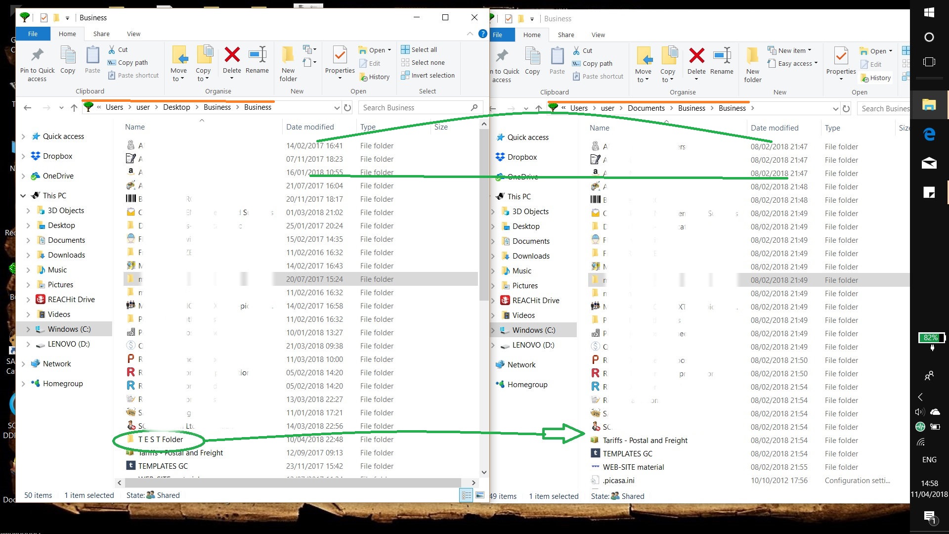

    I am uploading a picture of the same folder, accessed from different path. I tried the most obvious way which excludes the chance existence of two users. So the main path is:
    This PC > Windows (CThe same folder shows different content at the same time accessed from different paths :) > Users > user
    at this point I went in one case ... > Desktop
    and in the other case ... > Documents
    Followed, in both cases by: ... > Business > Business
    as you can see from the picture.
    I have circled a folder created and saved, that actually is visible following one path but not following the other.
    Also there are colour lines to point a couple of examples where two identical folders have different "last modified" dates.
    I have also checked one folder where I was sure no modifications have been made and discovered that the content of such folder - no matter accessed from what path, is in fact identical but for the dates "last saved" which differ entirely in day, month, year,
    time. It looks like if at certain point, accessing or saving a file or folder or sub-folder, via one path had become separate from accessing or saving after following a different path.
    I have not created (consciously or willingly) two different folders that initially must have been identical, as two separate items (e.g. one is the copy of the other like in a back-up) and also this PC has one single user (me) with access to the folders/files.
    I assume "Desktop" and "Documents" should not be two separate, non related, folders. But maybe something happened and a folder Desktop had been created (?)

    Hi C, it does make sense (I had to read and re-read The same folder shows different content at the same time accessed from different paths :) )
    In fact, It seemed to me, too that the folders are replicated because if that were not the case, one folder would contain much less folders/files than the other (supposing one was created at the time of start working on the PC and the other created by replication
    long after)
    Also, Using the desktop shortcut always seems to point at one folder (possibly correct) while using "save as" not necessarily points always at the same folder because the option available are Quick Access folders, Desktop folders, Documents folders and in
    some cases (excel) also Current folders, so that unless one knows where a certain folder or file had been accessed from, "saving as" option may point to one of the replicated folders.
    So, confused as I am, it is possible that your diagnosis would be correct. I will go through the lengthy, boring, painful process you suggested and see if it works.
    Tell me though if I am wrong: the theory is that I have folders/files in two different folders - Desktop and Documents - which are different from the default (those created initially) Desktop and Documents folders.
    I have checked the creation dates of the most important folder (Business,
    I called it BUSINESS to differentiate it from the folder Business in which it is contained) following the two different path and they are as follows:
    This PC > Desktop > Business > BUSINESS (02/10/2015)
    This PC > Documents > Business > BUSINESS (08/02/2018)
    Users > user > Desktop > Business > BUSINESS (02/10/2015)
    Users > user > Document > Business > BUSINESS (08/02:018)
    Because both versions (2015 and 2018) contain lots of data, I think I have not only to copy the content of BUSINESS 2015 and BUSINESS 2018 on the external drive but have also to merge their contents as some folders and files will be present in one and not
    in the other and viceversa The same folder shows different content at the same time accessed from different paths :(
    Also noticed that "Desktop" and "Documents" (checked by right-clicking) accessed from "This PC >" cannot be deleted (these may be the folders that Windows10 creates automatically) whilst they can be deleted from "C: > Users > user >"
    May this new information mean that the two replicated versions can possibly be those in C: >Users > user ? in which case I could simply (backup first) delete these and then follow your steps, then merge the two versions (2015 and 2018) and then put it back
    in either Desktop or Documents (the default Windows created Folders)?
    Hope that my rant and convoluted reply are clear enough for you to confirm or amend. I am no longer frustrated but excited rather, thank to your patience and help The same folder shows different content at the same time accessed from different paths :)
