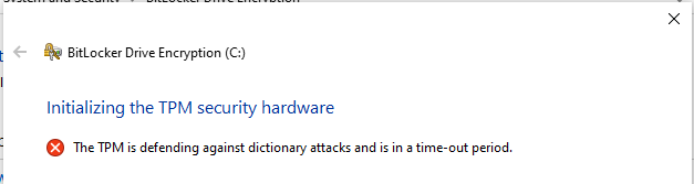

    I have recently re-imaged a laptop with Windows Pro 1909 and upon attempting to enable Bitlocker on the device, I am confronted with the following error:
    The TPM is defending against dictionary attacks and is in a time-out period. dc2f1ee2-f48d-4bf9-90ad-e683a8afc0df?upload=true.png
    "The TPM is defending against dictionary attacks and is in a time-out period."
    I have tried resetting and clearing TPM following these guides and forums to no success:
    • https://docs.microsoft.com/en-us/windows/security/information-protection/tpm/manage-tpm-lockout
    • https://docs.microsoft.com/en-us/windows/security/information-protection/bitlocker/ts-bitlocker-cannot-encrypt-tpm-issues
    • https://docs.microsoft.com/en-us/windows/security/information-protection/tpm/initialize-and-configure-ownership-of-the-tpm#clear-all-the-keys-from-the-tpm
    • https://community.spiceworks.com/how_to/140181-how-to-reinitialize-bitlocker-and-tpm
    • https://community.spiceworks.com/topic/1165283-tpm-lockout-after-imaging-surface-pro-3

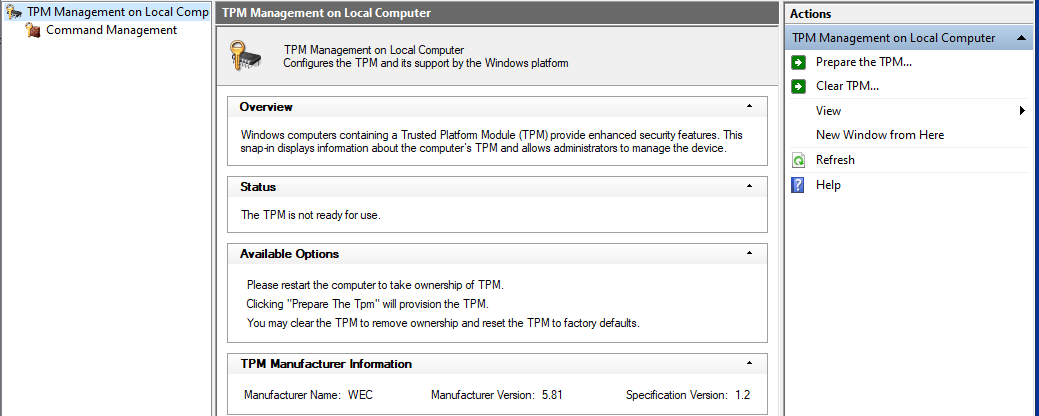

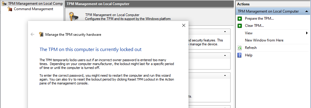

    This is what my TPM.msc currently looks like:
    The TPM is defending against dictionary attacks and is in a time-out period. a4506da5-5b84-41d9-95e8-735014371e7f?upload=true.png
    The TPM is defending against dictionary attacks and is in a time-out period. 5289029c-2cb5-4c93-b470-4e65fbd69abe?upload=true.png
    Any help or guidance on this would be greatly appreciated.
