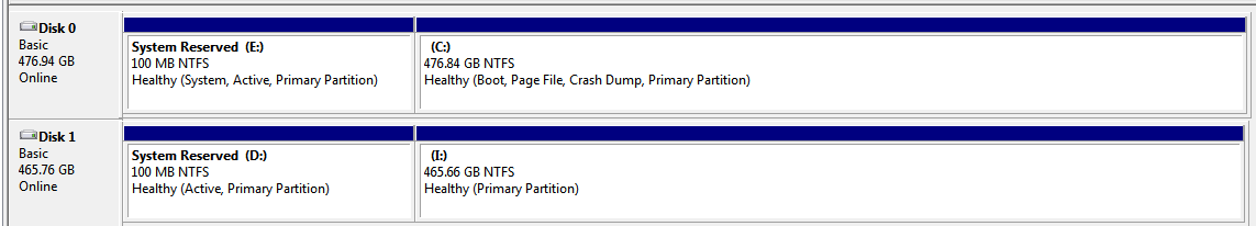

    Can DISKPART be used to make Disk1 active system partition and take Disk0 offline when both have System Reserved partition?
    I have added a second SSD to my Windows 7 x64 system because DISK0 was acting weirdly. (SMART BIOS said it was "bad" but the SSD manufacturer's disk utility said it was "healthy").
    I made a system image of DISK0 and restored that system image onto DISK1. Now DISK0 and DISK1 both have System Reserved partitions. Note that there is also a 2TB "standard" HD with several NTFS volumes which is not shown here:
    The win10 installation created a clone partition as Disk0 and Disk1. 83d89fd3-3f17-4f04-8beb-a475d0cd2463?upload=true.png
    With DISKPART, is it possible to take Disk0 offline, make Disk1 the active system partition, and reassign drive C: to the 465GB NTFS partition now labeled as disk "I:" ? Perhaps not in that order? If so, could you please give the commands in their proper
    order?
    The partitions on Disk1 are "MBR".
    Thanks
    TimR888, Nov 20, 2021

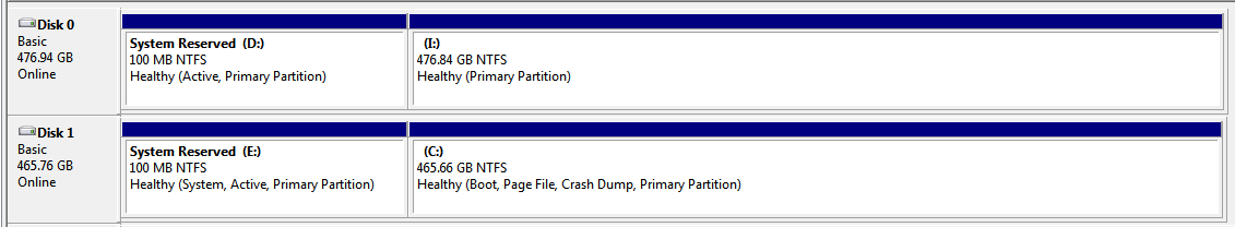

    Thanks for the suggestions. I made the new SSD first in the boot order and now this is the situation:
    The win10 installation created a clone partition as Disk0 and Disk1. 4a50ad2d-9619-4c84-a54b-a078ac48b86c?upload=true.png
    The "System" label is now on Disk1 first volume, and the Boot, PageFile, Crash Dump, and Primary Partition are there next to it. Drive C: is assigned to that 645GB NTFS partition, without needing to edit the registry. As you said, changing the order in
    the BIOS might fix the drive letters.
    So that is progress, thanks.
    But Disk0 is still active, not offline. Is there a way to take it offline without physically detaching it?
