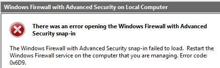

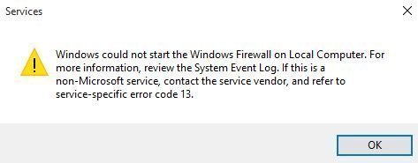

    This time of year, with Christmas fast approaching, I install some festive TrueType fonts (ttf) and print various cards and notes for people. Once done, I uninstall them until next required. Simples! Well, may be not so simple under Windows 10 (Pro). Attempting
    to install a font has led me a merry dance for 3 days now. What should be a quick and easy process has turned out to be nothing of the sort.
    Trying to be brief, researching the font issue led to suggestions that the Microsoft Windows Firewall must be active to install said font(s) – (that is another story). However, I have Kaspersky Internet Security 2016 (KIS) installed which has it's own firewall,
    and this disables the Windows version. So, I disabled the KIS firewall and attempted to enable the Windows one. The 'MpsSvc' startup type is set to 'Automatic' with a service status of 'Stopped'. Starting the service results is the following error message:
    The Windows Defender Firewall service terminated with the following service-specific error:... d06a4136-0a5e-430d-a649-92afe79dc1b5.jpg
    The System Event log entry for this states –
    Event 7024, Service Control Manager
    “The Windows Firewall service terminated with the following service-specific error:
    The data is invalid.”
    Exactly what data is invalid is anyone’s guess!

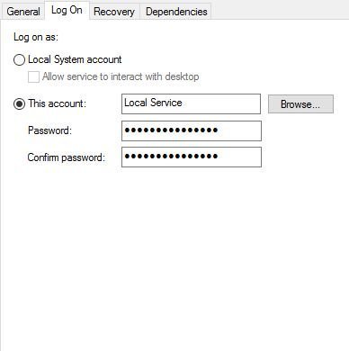

    One thing I did observe under ‘Windows Firewall Properties’ Log On tab, was that a password appears to have been entered. I don’t use an account password at all, so I don’t know where this has come from. Should it be there by default, or is it safe
    to remove? Could this be a part of the problem?

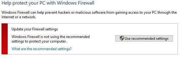

    Via the Control Panel/System and Security/Windows Firewall:
    The initial display is –
    The Windows Defender Firewall service terminated with the following service-specific error:... 71803256-0909-42da-b4bb-12c6241cfed2.jpg
    Clicking on the ‘Use recommended settings’ results in the busy cursor being displayed for about 15 seconds, but no other visible verification that something was done. Clicking on the ‘What are the recommended setting?’ link does absolutely nothing.
