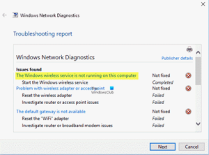

Discus and support The Windows Wireless Service is not running on this computer in Windows 10 News to solve the problem; [ATTACH]No matter where we are and what we are doing, we always search for a wireless network in the range. Imagine that you have to […] This article... Discussion in 'Windows 10 News' started by WinClub, Apr 26, 2020.

    For us to narrow down your concern for getting an error message "Windows wireless was not working on this computer", we would like to know the following:
    • Were there any changes made on your computer prior to the issue (e.g., updates, software installation)?
    • To make sure that we have not missed on anything, what troubleshooting steps have you done so far?
    Michael Gall, Apr 26, 2020
  3. Windows wireless service is not running on this computer?
    Hi Robert,
    I would suggest you to install the latest wireless drivers available on manufacturer's website in compatibility mode.
    Follow the steps below on how to install driver in compatibility mode:
    • Download the driver from the manufacturer’s website and save it on your local disk.
    • Right click on the setup file of the driver and select “Properties”.
    • Select “Compatibility” Tab.
    • Place a check mark next to “Run this program in Compatibility mode” and select operating system from the drop down list.
    • Let the driver install and then check the functionality.
    Hope this will resolve the issue. Do let us know if you have any other queries pertaining to Windows in the future. We will be happy to help.
    Thank you
    SujataMoktan, Apr 26, 2020
  4. The Windows Wireless Service is not running on this computer
    Thank you for updating us. It must be unfortunate that you are still facing the same issue. Let me help you.
    I suggest you to perform below mentioned troubleshooting steps and check if it helps.
    Method 1: Run the Network Adapter troubleshooter.
    Follow the below steps:
    • Type troubleshooting in the search bar.
    • Select Troubleshooting.
    • Select View all on the top left corner.
    • Click on Network Adapter.
    • Follow the on-screen instructions to run the troubleshooter.
    If the issue persists then follow the below method.
    Method 2: Update driver manually.
    I suggest you to update the Network Adapter from the Device Manager.
    • Right click on Start button and click on Device Manager.
    • Extend Network adapters driver from the list.
    • Right click on the Network driver and click on
      Update driver Software
    Check if it helps to resolve the issue.
    I hope the information helps. Please keep us posted on the issue. We will be happy to assist you accordingly.
    Aswin_Anand, Apr 26, 2020
