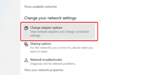

    IP configuration not valid - interference from ethernet adapter?
    Solution 1: No Internet Access In Windows 8.1or Windows 10
    Step 1:
    Go to Device Manager → Network adapters.
    Step 2:
    Expand it (Network adapters).
    Step 3:
    Select your network adapter
    Step 4:
    Right click on your wireless network adapter or Ethernet adapter and then tap “Update Driver Software”.
    (in this case your network adopter is Ethernet adopter so tap your Ethernet adapter)
    Step 5:
    Now on a new window you will need to click on “Browse my computer for driver software”.
