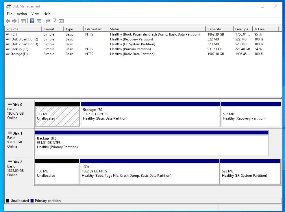

    Okay I figured out what I did wrong earlier and have done pretty much everything suggested. I deleted the extra boot entries in msconfig, properly ran the bcdboot command, and deleted the EFI partition on Disk 0 so the multiple OS options at startup are well and truly gone. So my Disk Management now looks like this:

    Now I want the Recovery Partition on Disk 2 as well. Since my new EFI partition ended up taking the larger portion of unallocated space, I'm assuming I need to shrink the Primary Partition on Disk 2 so there's enough room for a new Recovery Partition? Sounds like around 500 MB should be enough for Recovery. How would I go about creating the Recovery Partition at that point? It seems more tricky than creating the EFI was.
    CVraden, Dec 14, 2023
