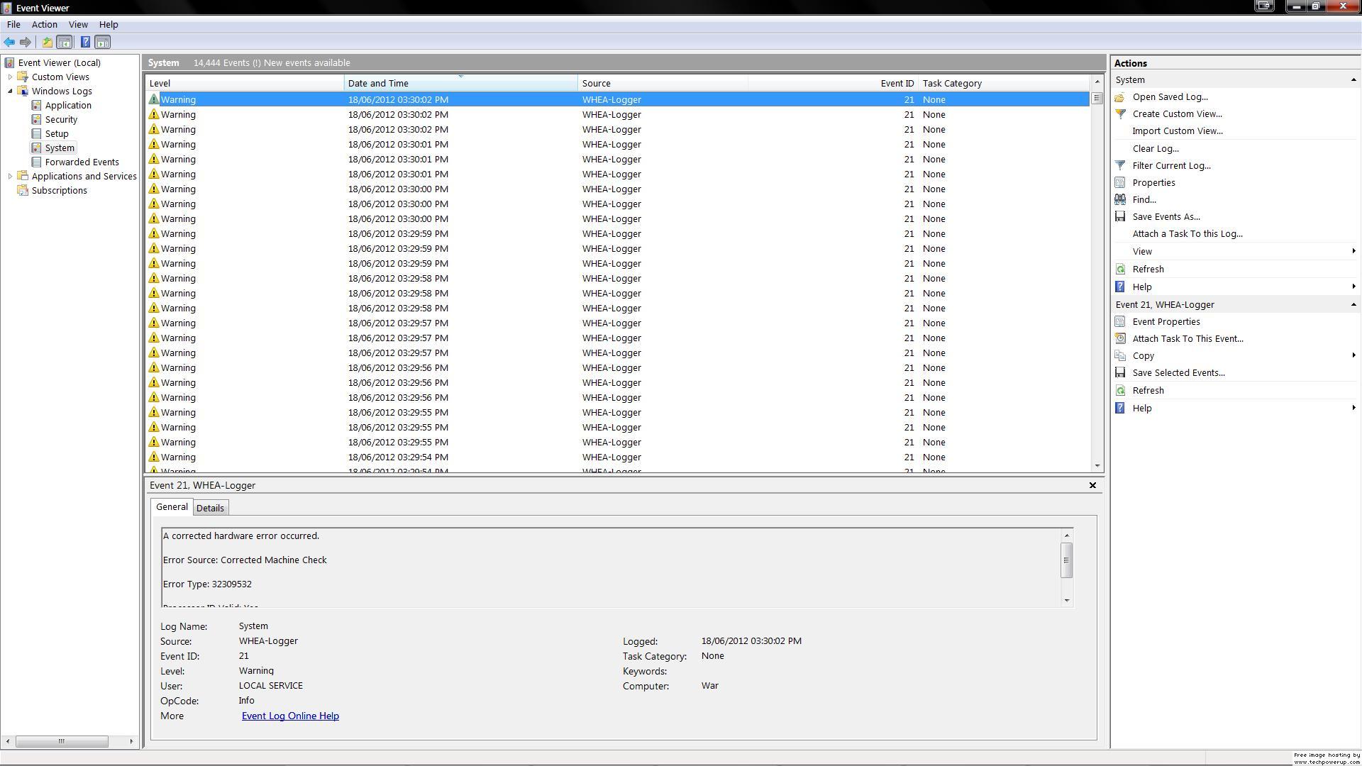

  3. cheesy999 Win User
    Corrected Hardware Error
    The computers been running slowly for a while now, but as of yesterday it decided it would delete part of the MBR, which resulted in me spending 4 hours attempting to get the data back
    Now I have finally got the computer into at least a usable state, I decided to try to find out what may be causing the computer to run slowly/crash/lose data, and I think I've found the source.
    Does anyone know what a corrected machine check is?, and what may be causing a hardware error to occur 3 times every second?
    cheesy999, Jun 7, 2021
